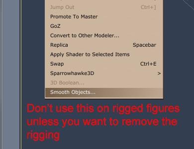

  • FenricFenric Posts: 351
    How are you trying to smooth it?
    The correct "rig preserving" way is to double-click the figure to open it in the modeller, hit control-A to select everything, then change the radio button to "smooth". It is rarely a good idea to go beyond "1".
    You should never use the menu option in the assembly room unless you intend to break the rigging (which is very useful sometimes)
