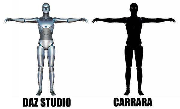

JoepingletonJoepingleton Posts: 746
I have not been able to figure out how to get the Materials for Bot Genesis to work with Carrara. Attached is the difference between Daz Studio and Carrara. Is there a way to get Bot Genesis to work in Carrara?
814 x 494 - 36K
    I don't have the product so this is just a guess. Until someone who has BotGenesis comes along, I have a few suggestions.
    1) Daz has been setting the default placement of some Genesis-related materials as a subfolder for the character. For example, in the attached pic, the materials for the Azumi character for Aiko 5 of Genesis is in a subfolder of the Azumi folder under Genesis under People in the "My Daz3d Library" folder. That is using default install, so if you do custom installation it would not apply. However, the materials will be wherever the creator put them, so they could be in a materials subfolder. In any case, explore your My Daz3D Library content folder.
    2) Use Daz Studio as a plugin. Load the BotGenesis in Studio with the materials that you want, then in Daz Studio choose File / Save As then choose a character preset. You should have a "My Library" folder in your Carrara content browser with a subfolder called presets and a further subfolder for characters. try loading from there.
    3) Dare you try the Smart Content tab? I never do, so that is just exploratory.

  • evilproducerevilproducer Posts: 9,040
    The other possibility is that the textures are not image map based for once, which would be weird for a DAZ Studio product. ;-)
  • DartanbeckDartanbeck Posts: 21,219
    Even still, you may find the same issue, simply as Carrara translates the DS materials to Carrara shaders.
    Here are some things to check:
    For efficiency sake and to save some headaches, after loading your materials, if you do, don't forget to consolidate duplicate shaders.
    Now go in and look at the color channel first. There might be a nested routine going on in there that isn't necessary in Carrara. In that nest should likely be a texture map. Drag that map directly onto the color channel to get rid of the rest of the nest, leaving only the texture map.
    This sort of thing can be found on the eyes, quite often, when converting from DS materials to Carrara shaders.
    Look through each shader and all of the channels used for things like this. As a helpful hint, when things look 'black' but they shouldn't, look around in the shaders for something black that shouldn't be.
    If that's not the thing, perhaps the material was relying on something other than the color channel to simulate the appearance. In this case, you might see "None" for the color.
    If that's the case, try turning Shininess to 0.00 and then test render. Sometimes we use Highlight vs Shininess to let light create the color, rather than using the color channel at all.
    Be aware that some such shaders will want to rely heavily on reflection, which can really tax your render times. A great question to ask yourself is this: Do I need to actually see reflections, or do I just want it to look shiny?
    Often we can get great reflections with a very low value in the reflection channel itself, and simulating the rest with a brighter (higher value if a number) Highlight input, against a then finely adjusted Shininess value or map. To let light wrap farther around a surface, go closer to 0.00 and to tighten up the shine level, try going closer to 30, possibly 40 if you're rendering in very high resolution, but if you lose shininess, go back toward 18 and work it from there again.
    In these kinds of shaders that rely not on a color channel, but the others, you'll need something for a background and a good lighting solution to actually tweak the shader. This could be simple, like adding a color in the Scene background effects, but not black or even too, too dark!
    Sometimes we might just not like what we're getting form trying to tweak out DS materials that don't make use of any maps. Some DS materials are procedural. And if that's the case, you can always drag Carrara shaders onto the subject instead. I use Ringo's DP Shaders for this too. That's where I love having a huge shader collection :)
    Hopefully some of that babble can help you on your way. If not, we can dig deeper ;)
  • bighbigh Posts: 8,147
    did you try saving a DUF scene in DS
    then make a new scene in C8.5
    then import the DUF scene from DS .
  • JoepingletonJoepingleton Posts: 746
    edited March 2014
    Thanks for all the info. The sample was from loading a DAZ Studio file in carrara 8.5 Pro. I tried loading it from the content browser and tried the other suggestions. None of them worked. It may be that the shader is DAZ Studio only and I'll just have to add a metallic shader instead.
    Post edited by Joepingleton on
    Also, sometimes loading materials from the library in the browser don't seem to work. Try loading the thing in like normal, then before doing anything else, consolidate duplicate shaders and go in and look at the shaders.
    Pick one of the most visible domains from the list on the right and double-click it to open it
    Look carefully at the color channel. Is there a texture map in there? If so, is it all by itself or are there more Sources in the channel? If it is not alone, make it alone by dragging just the texture map channel onto the color channel in the left portion of the shader window.
    Look carefully at the Top Shader. Are there any functions added to any of the channels that might mess with it's appearance, like Alpha, Transparency, etc., For testing purposes, I'll often turn everything to None except for Color and Bump, perhaps Alpha if it's something like hair that requires it. Sometimes I'll leave value sliders in Highlight and shininess too.
    I've just noticed nested image maps in Alpha channels and color... even in the bump channel.
    Carefully comb through and just get a simple shader going and if no texture maps were applied in anything, look in the textures folder for the product. Notice which maps are there, so you can add them to your appropriate channels in Carrara:
    Main Texture maps - Color Channel
    Texture_B - Bump Channel
    Texture_S - Highlight channel - often needs to have the Brightness slider under the thumbnail turned down some.
    Some products come with normal maps and can be used in place of bump by changing the channel from texture map to normal map in the drop-down
    I've been planning on experimenting more with using SSS maps in Carrara, but they don't translate directly into how Carrara handles SSS without the help of something like Enhance C, or is it one of the Shader Ops?
    edited March 2014
    Thanks for the tips.
    I just consolidated the shaders and applied a metallic shader for this experiment. Bot Genesis Animation.
    I love the DAZ studio version's look and how fast it renders. But O have been so much happier animating in Carrara. I guess more experiments are needed to match the DAZ studio look.
    Weren't there any maps for it in it's Texture folder?
