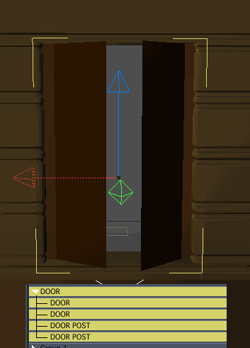

I have a group of objects that i want to move higher up the hierarchy. when i move the group folder it breaks the orientation of the objects in group. if i ungroup the group it moves everything in the group randomly. the doors have a shaft constraint on them to swing open, other than that nothing unusual about the group. see attached. Anyone help? thanx I can move them in the vertex modeler without any distortion

  • tbwoqtbwoq Posts: 238
    Disable 'Use Constraints' icon at the top of the scene window, then move or ungroup. Then re-enable. Parenting then unparenting constrained enabled objects(etc.) may cause some objects to continually adjust to a new hierarchy.

    disabling use constraints did it nothing else. just to clarify something, i thought parenting was dropping the object on to the object being parented to and grouping was just grouping by making it a group-select objects and Command G. arent they two different things?. why would moving a group require disabling constraints? my depth of knowledge of carrara is sorely lacking, please pardon my elementary questions. Thank you for a speedy reply tbwoq.

  • DartanbeckDartanbeck Posts: 21,223
    Try selecting your group and hit Ctrl G to group it again, then move it up the hierarchy. If that works, you could try to then drag the one group out from the other and see if all stays well. Not sure if ungroup would go deeper to remove both? You could try that too.

    Hi dot_bat.
    A Group is just a hierarchy name to help contain objects for easier navigation(etc.) The main difference between a Group and Parent link, is that a group is not a master object. It can't 'link to' or affect the relationships of the objects inside of the group. To do this, you must promote the group to a master(Edit->'Promote To Master').
    The issue of objects moving when they change in the hierarchy or ungrouping could be due mainly to when you constrain an object. Carrara will not only set the constraint but also set the reference point.
    So if you group a constrained object, move the group, then pull the object out of that hierarchy/ungroup, it snaps back to the reference point in the universe you first constrained it. At least that what is does in my testing.
  • dot_batdot_bat Posts: 373
    thanx tbwoq for the explanation, thats what was happening. didnt know any of this, now filed away
