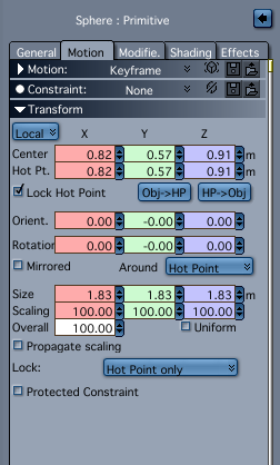

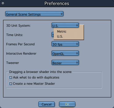

    It's user defined. Carrara has diffferent scene magnitudes. A small scene will be measured in inches or centimeters (depending on preferences), a medium scene will be measured in feet or meters, and a large scene will be measured in hundreds of feet or hundreds of meters.
    The wizard screen that appears when creating a new scene does default to inches and feet when describing the scene scale, but once in the scene, they display as metrics if that is how you set your preferences.
    252 x 418 - 43K
    369 x 348 - 36K
