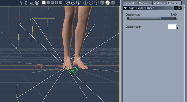

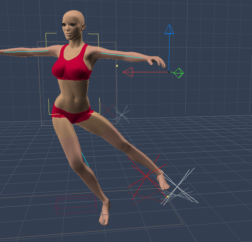

    So, what I do is drop in a target helper object. There's a bulls eye icon at the top of the Assembly Room window. If I want to lock the feet, I position it over my foot. Keep in mind the hotpoint for the foot is the ankle joint, so position the target helper over the ankle.
    You can adjust the size of the target helper and its color in the target helper's effects tab. If you want a target for both feet, you can either add a new one or use the Duplicate command under the Edit menu. I also rename the targets in the target helper's General tab, to something like, R foot Target and L foot Target, just to keep things straight.

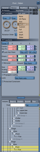

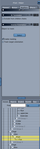

    Next, select one of the feet in the figure's hierarchy and select the Modifiers tab. You should see the Inverse Kinematics modifier with the option to choose an object to track. Click the icon and select the appropriate target helper. You can also select the option to track the object's orientation. This may provide a little more control keeping the feet locked in position.
    A little added tip that I figured out recently is that if you change the constraints of the foot joint to Ball joint, and use Track Object Orientation, you get a near perfect pin to the floor. If you drag the hip to the point where you exceed the length of the limb then Carrara will do its best to keep the foot tracking the target, but it won't stay pinned.
    You can also keyframe the tracking, by enabling and disabling the Enable checkbox over the length of the timeline.

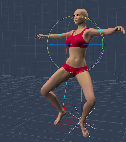

    So here's an illustration of changing the foots constraints to ball joint. The first linked video shows the standard constraint on the left foot. The second video shows the effect of the ball joint constraint. You'll notice there is no float or shifting of the foot in the second video.
    Note that except for head, eye and right leg movement, the entire animation is done by using IK. Meaning I selected a limb and moved it, and the rest of the rig followed.
