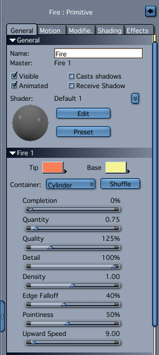

I've been asked to post the settings for this video. This actually uses three elements. The fire primitive, a light bulb with some effects, and a particle emitter.
There are some caveats to using the fire. It does not react to scene forces and it has no controls to simulate forces such as wind, wind direction, or wind speed. These would be welcome improvements in future updates. It can also cast shadows, they are not opaque, but it can cause some weird artifacts, so if you don't want them, I would turn off the cast shadows option. The fire primitive can also provide illumination provided you use Indirect Lighting in your render.
I couldn't find the original scene file, but I did save the torch to my Objects browser and that includes everything except the particle emitter which I'm trying to recreate
I've found that the default colors are too cartoony. I find I can get a more accurate look if I adjust the colors much brighter. Yellow in the base color and I usually brighten that to a very light yellow. Of course, there are times when you'll want a more fantastic color such as for a magical or sci-fi effect, in which case, whatever color you choose, I would go for a bright version of it.
I also like a high detail, and high edge falloff. I usually don't increase the pointiness from its default and many times I will reduce it somewhat. I've found an upward speed of 8 or 9 works best for me. Your mileage may vary.
The fire itself doesn't cast a light unless you use Indirect Lighting in your render, so what I do is stick a bulb light into the fire. I leave it pretty bright and set the color to approximate the fire's color. I also add a 3D Light Sphere in the bulb's effects tab. This helps sell the brightness or heat of the fire.
If you are animating the fire, the fire should be set to 0% at the start of the animation. Scrub to the end of the timeline and adjust the fire's completion to 100%. To get a flickering firelight, you can set the bulb's brightness to 100% at the beginning of the animation and 50% at the end. Change the tweener type to noise and choose Cubic. The T-scale is the time scale. Fire flickers rapidly, so you'll want to to adjust the slider so that you get a lot peaks and valleys. You can also clamp the peaks and valleys if you feel the valleys or peaks have too much variance.

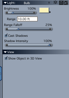

    Here's the setting for the light sphere:

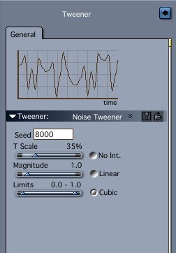

    I would set the completion at the starting frame to 0%, and scrub to the end f the timeline and set the completion to 100%. The upward speed will determine how fast the flames move.
    Also, stick a light bulb in the middle and set the color to match the fire. Make sure to uncheck the cast and receive shadows option for the fire. To have a flickering light effect, start the bulb at 100% brightness at the start of the animation and at the end set it to something around 60%. Change the tweener to noise. For 20 seconds you would want to adjust the T scale (time scale) to compress the noise and make the flickering faster.
  • That Other PersonaThat Other Persona Posts: 381
    Awesome! That looks great! I had never played with tweener settings before; there is soooo much to learn...
    I went with an up speed of 7; fine for the look I want for now. So many settings that I still need to play around with to really understand it all.
