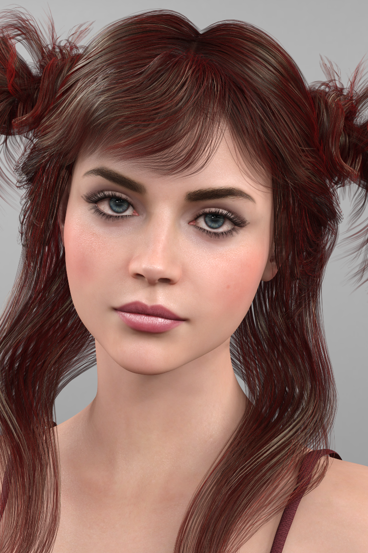

    Here's my attempt at recreating her.
  • Blind OwlBlind Owl Posts: 504
    That's pretty darn close! So when can we expect to see the product in the store? wink

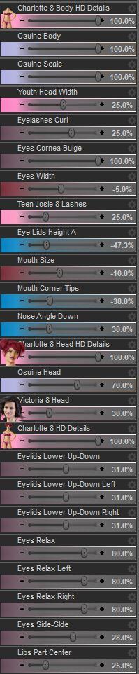

    BTW, all I did was turn down Osuine a bit to 60-70%. I then added a small amount of Victoria 8, 25%. It is pretty clear to me that the girl has some kind of HD shape in the promos, so I added Victoria 8 HD, 100%.
    The texture is straight up Osuine. The 2nd pic I added more red to her cheek by blending in the SSS texture in that area. I used Osuine blue eyes, and I turned down the white level on the sclera because it is too bright otherwise.
    And that is it. I think its pretty close. It is possible the artist is using a different DO as the secondary shape. I am pretty confident it is a Daz DO, because of the HD morph. Though I suppose it could be a PA's HD shape. It must be someone who can balance Osuine's face.

    Thanks @Outrider42 for sharing your "recipe", you clearly got very (very) close. I was struggling with the wide nosebridge in comparison to straight Osuine morph.
    Definately agree with you about the hd morphs part, especially the side eyes wrinkles and neck folds !
    For the eyes texture, you can also have a try on blue eyes materials from any Emmaandjordi G8F character, you will get fine details in the sclera veins.

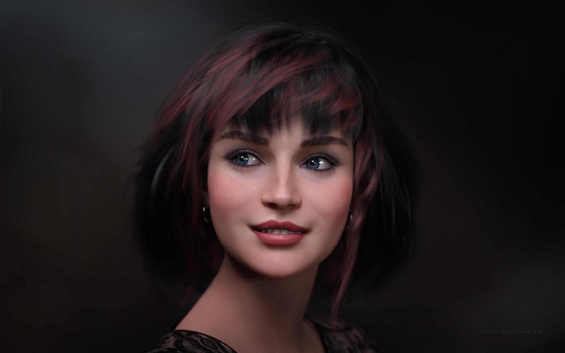

  • ArgleSWArgleSW Posts: 148
    edited May 2019
    2000 x 1300 - 2M
    199 x 962 - 57K
    Post edited by ArgleSW on
  • SixDsSixDs Posts: 2,384
    That's pretty impressive, too, arglesw007. I think that one important thing that this illustrates, is how important the texture set is to creating a credible clone, not just in this case, but every case. Of course, the people behind Facegen and Headshop certainly know this.
