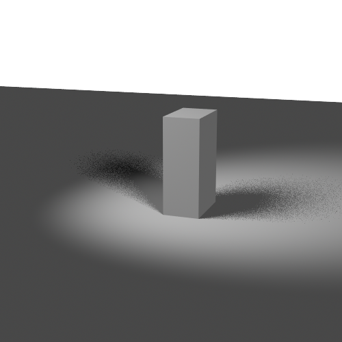

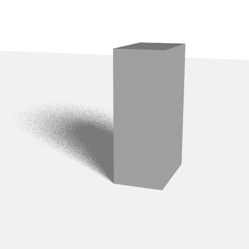

Noisy Shadow (after activating Shadow Softness)
cschneicschnei Posts: 0
If i activate "Shadow Softness" on a Distand or Spot Light the shadow gets noisy/pixelated/grainy.
The render settings in this picture are set to default.
But i tried every possible value to remove this noise.
Can someone give me a hint, how to remove this noise.
500 x 500 - 179K
500 x 500 - 135K

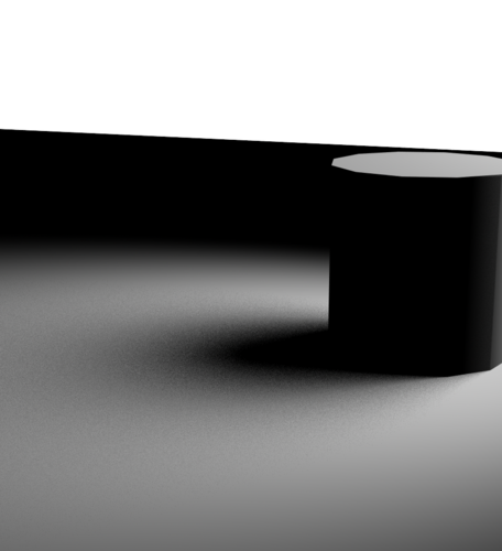

    After your recommendation, i tried the following settings.
    Shadow Samples = 64
    Shading Rate = 0.01
    The first picture shows the default render settings, the second 64/0.01.
    Any other recommendation. Cause 64/0.01 are the maximum and minimum values of the two setting sliders.
    927 x 1017 - 638K
    927 x 1017 - 725K

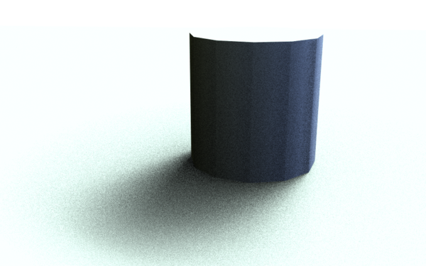

    Wow, thx for testing it by yourself.
    If i use the Uber Environment Park. The noise is really extreme.
    After searching for it, i found pictures of people which dont' have this problem.
    So there must be a solution to it.
    920 x 575 - 565K
  • MattymanxMattymanx Posts: 6,793
    you are using UBer environment or normal lights???
    if uber, then you need to adjust settings for UE as well as your advanced render settings
  • cschneicschnei Posts: 0
    I tried normal lights (first picture) and Uber Environment (last post).
    Both resultet in noise.
    I used the standard and default values for everything.
    I created a standard plane (without changing any creation or surface value)
    I created a distant light (only changing the shadow value from none to raytraced (software) and increasing the softness value from zero to 30).
    Thats all.
    I used the default values for everything else.
    The values from Vanguard help to reduce the noise.
    But its still visible if i use the following values:
    Shadow Samples: 64 (max)
    Shading: 0.4
    Pixel Filter: 16/16 (max)
