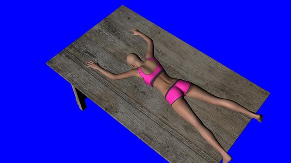

I want to be able to make Gen 2's right arm hand ect.. Look like left arm hand ect.. Is there a simple way to do this?
Also when I do want to make hands, feet, toes ect. look the same on both sides is there an easy way to do this?
Also I have trouble turning her head 90 degrees. Do I need to adjust the collar chest area? What i'm I missing.

    I do that by write down every posing parameter for the one side and apply them on the other side (sometimes, actually often you need to change the sign though).
  • Cayman StudiosCayman Studios Posts: 1,065
    For symmetrical posing you can use the Symmetry dialog box (Edit > Figure > Symmetry; or Shift+Y). For example, if you want to mirror the right arm, hands and fingers on the left, you select Right Shoulder in the Scene tab, then within the Symmetry dialog box set Nodes to "Selected", Propagation to "Recursive", Direction to "Right to Left" and click Accept.
    Regarding the Head turn: the figures, including Genesis 2, have rotation limits set on the joints so that any pose you make will simulate what the human body is actually capable of so that the pose will look natural. (You can turn these limits off, or manually change these limits by clicking the cog symbol against the movement in the Parameters tab, and selecting "Parameter Settings...") Try the sunbathing pose with the neck twisted 35 degrees, and the head 30 degrees - these are the natural limits. You can get a further twist with the chest for the natural look. If you still want her to twist a bit more then you can try tinkering with the limits.
