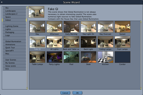

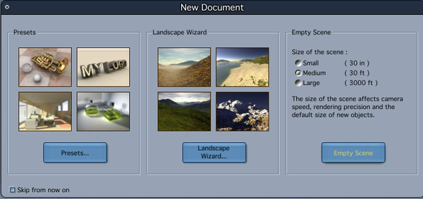

  • evilproducerevilproducer Posts: 9,040
    If you have the Carrara native content installed, there are scene presets that can be a valuable learning experience. Using the Wizard, choose Presets--> Indoor. There should be a whole lot of options. Click on the thumbnails for a description. There's also a scene preset that uses faked GI. Take a look at what was done to see what you can do.
