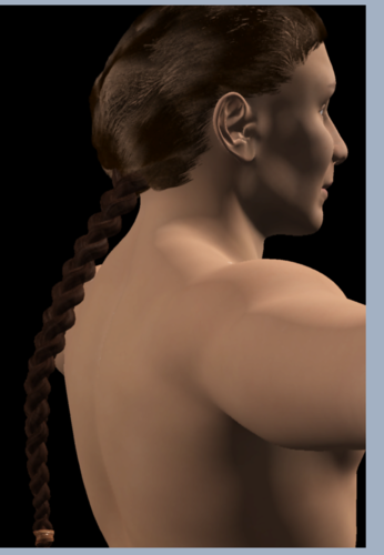

    I have a pesky hair problem...I bought Vayne Braid and cannot get it to show in my DAZ content folder at all. It came as a zip that I had to install manually and it just isn't there in Carrara. So I opened it in DAZ and then exported it as dae. Once in C-beta it looked OK but was so small. So back to DAZ and enlarged it a lot, then re-exported it. I must not be setting my export settings correctly? But didn't see one for scaling.
    So now I actually have an object. I faffed with the scalp hair, eg removed the girly fringe, moved the braid around to the angle I wanted, but am looking for a way to lock it onto the Genesis model head vs just having it grouped? Is there a basic tut someplace for this? I am happy to manually more the braid's bones for positioning. The braid is visually nested into a Carrara hairstyle I made and I like the look. But your way will make it much easier when using hair that works properly in Carrara for custom styling. See image below. Any advice welcome and thanks again to all for this thread and info!
    ETA, I also turn off highlight and shine to zero. Ceramic hair just looks plain weird.
    Cheers, SileneUK
    530 x 767 - 251K
