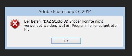

  • msorrelsmsorrels Posts: 44
    It doesn't work for me. Works fine with Photoshop CS6 (both 32 and 64 bit) but with CC 64bit (I'm not wasting time with 32bit any more) you can't launch the plugin. Inside Photoshop it gives a "Could not complete the DAZ Studio 3D Bridge command because of a program error." message. Which has happend in the past and needed DAZ to update the Photoshop side of the plugin pair. The DAZ installer also doesn't find the CC directory (though that's not a big surprise).
  • SloshSlosh Posts: 2,391
    Any update on this issue? I just signed up for CC today, in hopes of being able to use the Photoshop Bridge, but I get the error mentioned above.

  • DAZ_SpookyDAZ_Spooky Posts: 3,100
    The Photoshop 3D Bridge does not work with Photoshop CC. Adobe changed something and we haven't figured out what it is yet.

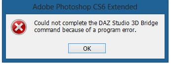

  • Sal UKSal UK Posts: 432
    Oh well looks like it doesnt work with CS6 Extended Either!
    346 x 134 - 35K
  • Richard HaseltineRichard Haseltine Posts: 92,104
    I never use it, but it is working with CS6E here.
    Thanks richard, I have a feeling it maybe with win 8, as I have been trying most of the day to get it working with no joy.. :(
    Steve

    I can confirm also that it does work with PS6E (and PS5E for that matter).
    A few things to check:
    Be sure DS, Photoshop, and the bridge all have the same bit, either 32 or 64, no mixing and matching.
    In DS, go to Help > About Installed Plugins and look for 3D Bridge in the Daz Studio Pro Plug In Bundle section.
    This will let you know if it's not installed (doesn't show up), or just not working properly (green vs red plug icon).
    For Photoshop, if it shows up under File > Automate, then it's installed properly on Photoshop's side of things.
    Post edited by Lissa_xyz on

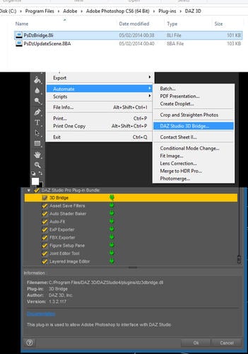

    Thanks for the help in trying to get this to work, here is the info on the plugin from Install Manager, Photoshop, and Daz Studio Latest version.
    **EDIT** Just to add I am using Windows 8 pro 64bit.
    624 x 890 - 189K
    645 x 29 - 28K
    Post edited by Sal UK on
    edited February 2014
    Ok, I noticed by the path that your Photoshop is 64bit. Is Daz Studio and the bridge also installed as the 64bit versions?
    If they are all matching versions, everything should work fine. I haven't upgraded to Windows 8, so I couldn't offer any help on an OS level.
    *edit*
    Damn those international dates. I went to cross reference the date on your plugin shown in your Photoshop folder and was like wait, May 2014?! /sigh lol
    *edit*
    lol Oh I wish it was May... :)
    Yes I have 64bit DS 4.6, I will install the 32 bit version as Photoshop installs both 64 and 32 and see if the 32 bit version works though I suspect it being windows 8 not allowing it to communicate with each other. I have Tried disabling UAC and also tried running all as Admin but this has me beat...

    One thing I haven't asked.. how are you loading it?
    The smoothest way I've gotten it to load is by first loading the bridge in DS, then loading it in Photoshop. I've seen people have some buggy behavior when launching DS from the Photoshop bridge panel.
    Hi Vaskania
    I have tried starting in DS then loading up Photoshop and starting up 3D Bridge in PS, I have loaded up photoshop and tried launching DS from Photoshop. I really think it is windows 8 the way the files are accessed in a different way is messing it up, I have'nt done the Win 8.1 upgrade yet as I thought ill wait and see what problems others have with the 8.1 maybe if it dont work on my Laptop tomorrow I will try updating see if it has anything to offer in making it work.. lol
    Steve.
