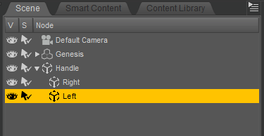

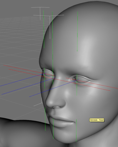

  • JaderailJaderail Posts: 0
    The better way is to position the Null just inside or behind the Camera. I'm not sure why but that gives that effect of look at the camera man not the camera as suggested in TV. Also a better Eye pointer is a three null rig. Load your Figure create a LEFT null position just in front of the left eye then Create a Right Null, position just in front the right eye, now create a Handle Null position it just in front of and between the other two nulls. Now parent the Left and Right to the Handle. Then do Point at for left eye to LEFT and right to Right. You move the Handle Null as you like and the eyes follow. You can also then tilt or rotate the EYE set for many more eye effects than just a basic Single Null.
    Here is my Basic Rig in Viewport and the Scene Tree.

  • Lissa_xyzLissa_xyz Posts: 6,099
    Can you parent the handle to the camera also so they always follow when you move the camera?
    I see no reason you couldn't. Just remember to position and test before you decide to Parent. I use a Eye rig for most renders, even ones that have the figure looking at objects. I position the rig just behind the focus item and rotate the rig so it is aimed at the Figures eyes. I do most of my positioning in Perspective view and then go back to my Render Camera for a test render.
