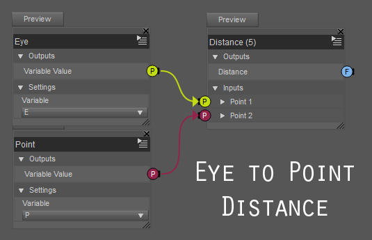

Since the current depth-related stuff in Shader Mixer is camera-only, here's a snippet of code as a custom brick which allows a surface-based depth shader. Maps the scene from white (close) to black (far) based on min and max variables.
ShareCG link including custom bricks for the depth map functionality itself and the basic raw 'distance between viewer and surface', plus images and a Shader Mixer file so the internal nodes can be poked through more easily for those who have the inclination to do so (ungrouping the brick unfortunately messes up the arrangement).
The bricks in the network have been retitled to make their function more understandable. The following post explains what's going on.

    First set of components: Two Variable [Fixed], one set to E (this gives the position of the viewer) and the other set to P (this gives the position of the surface). Plug both of them into a Distance brick, and it gives you something that will spit out the distances between points on an object, and the viewer. I personally grouped this and saved it as a custom “Eye to Point Distance” brick so I could work with it more easily later.

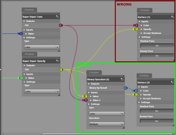

    Now, can anyone tell me why it is that the opacity of the Surface root itself doesn't work right with transparency? Even with a completely black image plugged into the opacity input, the surface is only partially transparent. Is that a bug?
    Just a guess: Sounds like you forgot to (pre-)multiply the color with the opacity. Technically it is not wrong, but it will look strange in the render (the color will be added to whatever is behind it). The Default Material Node contains the multiplication internally, but when using the Surface root node directly, you will have to do it yourself.

    Wow, that's strange. I'd never have guessed. Thanks very much for the explanation. That's been bugging me for pretty much all of the shaders I've been playing with, and most of them I'd rather not go through the DAZ Default Material, which was the only way I found to fix it so far.
  • ReDaveReDave Posts: 815
    Thank you Millighost. That was a rather perplexing issue that was bugging me as well.
  • Richard HaseltineRichard Haseltine Posts: 68,649
    The tinting effect came up a few weeks back and I opened a bug reprot on it, one of the devs told me the same as millighost posted above so that is the official answer.
