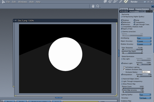

    The above settings with Global Illumination with or without indirect lighting should resemble your pose product images, for example.

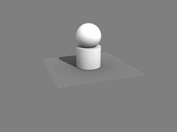

    The below image is the default, new empty scene without changing anything except the following:
    Sphere and Cylinder primitives have the above shader settings
    Plane - default (grey) shader, but turned highlight and shininess to 0%
    Default Light Brightness turned down to 60
    Scene - Background - color - left the gray that came in on default
    Render settings are default except turned on Global Illumination:
    Hope this helps. Love your Arachnoid and Infiltrator set! Bravo man!

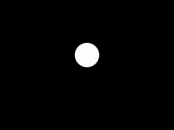

    That looks pretty sweet, the GI brightness seems to be exactly what i need, but I'm not sure I understand correctly.
    Will it be able to do this for example:
    I have a white plane as floor, and a white sphere with glow.
    Rendered with GI I get picture 1
    When rendered without GI I get Picture 2
    What I would like is to get the results of picture 2, but with Gi turned on. (In daz studio, one can just set the ambient color to white, but i don't see this option in carrara)

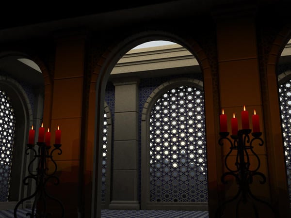

    Here is a pretty old image I did with this plugin (Carrara5 I think) when I was trying to learn GI...
    The wax candles and the flames use FLAT to remove their shaders from interacting with the scene...
    The "buildings" outside are also just a plane with FLAT used to control the grey gradient on the cutouts precicely...
    640 x 480 - 97K

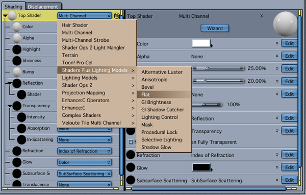

    Here's how you set up the FLAT shader. It's actually an alternate Lighting Model, so the render engine treats it differently. What ever is in the color channel is what it will be....
    1068 x 709 - 189K
    651 x 415 - 117K

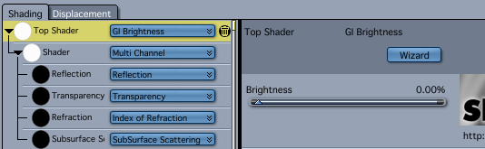

    GI Brightness gives the same result but a different route. The white color goes in the glow channel, but you turn GI Brightness to 0
    Both are handy to have if you are using GI for lighting.... Otherwise you have no control over it.
    1069 x 709 - 191K
    534 x 165 - 36K

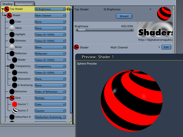

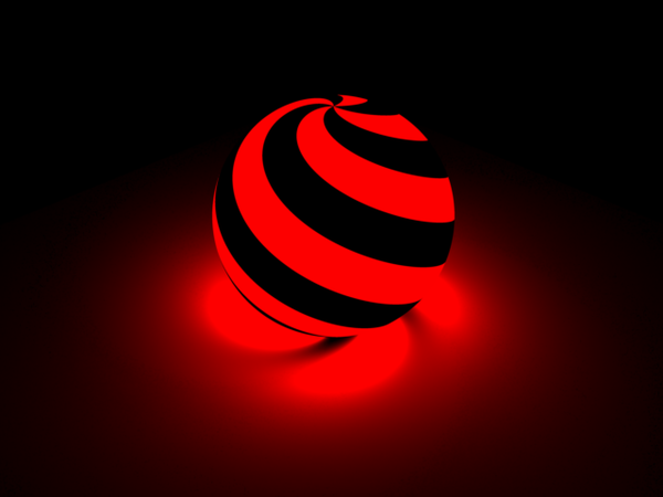

    Here's GI Brightness used with a pattern shader in the Glow.... If you've ever tried this without the plugin you know you lose all control over the amount of light emitted because the glow channel is no longer a simple color... GI Brightness corrects that. Notice how the pattern is clearly shown in the emitting light...
    (my ground plane is default grey, not white... oops again)
    640 x 480 - 83K
    688 x 518 - 127K

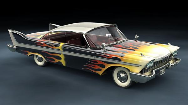

    In case y'all were wondering what the fuzz was about: Needed to make promo images for textures so it was important to get nice and even lighting. The surrounding objects kept messing up the lighting and made it very difficult to control. I ended up getting the plugins, borrowed my mom's CC :D
    Still not entirely happy, but it's the best i can do atm :(
    Thanks for all the help! :)
    1295 x 727 - 94K
  • evilproducerevilproducer Posts: 9,040
    Very nice paint scheme. Is it your model as well?
