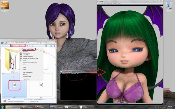

  • ZilvergrafixZilvergrafix Posts: 1,378
    edited March 2013
    in my experience, just click on the RIB file and automatically renderdl is executing.
    no need to typing on system console window. the new version includes "shell extension?" like winzip or winrar does.
    1920 x 1200 - 537K
    Post edited by Zilvergrafix on
    Windows version...yes. Linux version needs to be manually setup to offer that. Mac version, I'm not sure about...but probably needs to be setup too.
