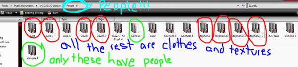

I have been doing a lot of reading, but I'm not finding what I'm needing, so I hope this thread isn't duplicating something I missed.
I have read "How to use Iconic Shapes for Genesis in 8.5Beta", "Carrara 8.5 beta Meets Genesis (Starter Tutorial)", and a couple others dealing with Carrara and Genesis, but I can't lock down the following issue:

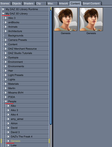

I can load Genesis (it took me a while to find the one that loads the Genesis object), but when I click on the Actor Tab, under the Instances Tab, the Parameters Tab >> Root selection shows a list of over 650 Parameters to search through. Parameters >> Root >> Actor shows the same. After working through the list of selections, I finally got down to Parameters >> Root >> Actor >> Female where I found the Gen 3 female characters and the Gen 4 female characters, but the only Gen 5 I could find was Victoria 5.
I have installed Aiko 5, and Stephanie 5, as well as Victoria 5, but they do not appear anywhere. Neither do my male Gen 5's show under Male Actors. I have searched the entire directory structure, but I cannot locate a single Gen 5. What am I missing?
I have Carrara 8.5 Pro Build 172 (64 Bit)
Just FYI (don't know if it makes any difference) I have Hexagon 2.5, Studio 4.5, Bryce 7.1, and Poser 7, all with the latest builds (except Poser, of course, but I have all the updates for P7). I mention these in the event of some form of incompatibility issues I may not be aware of.

    In the "Content" tab of the Carrara browser, find My Library and/or My Daz3d Library (if the issue was as above, you should now see both in Carrara), go to "People" > "Genesis" > "Characters", I think. Working from memory, here. In that folder, you should find all of your character presets.
    If none of that works, your other Gen 5 people may not have been installed properly - try installing them again.
    Another tip,
    In Carrara, some shaping morphs are found under the second line called "Genesis", while others are found under "Actor", but they're not the same set. "Actor", I think, is where the main Gen 5 shapes are found, towards the top of the list.

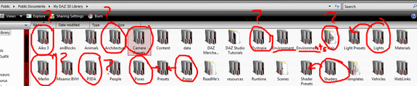

  • staticstatic Posts: 325
    edited March 2013
    Dartanbeck & 3D Age -
    Thanks for the info. :coolsmile: This is still so frustrating, but to answer Dartanbeck's last question first, let me relate a bit of history:
    I have been using Poser since about 6 month's after Poser 4's release. Back then, everything was in one directory, and there was a limit as to how many items Poser could "see" in that directory. That's why so many User Created Content out there have folder and file names that start with ! , !!, or even !!!. These come first in a computer's alphabetical sorts. This meant that their content would be at the beginning of the alphabetical sort and, therefore, least likely to get booted off the list (essentially ignored), as regardless of sort order, Poser would only read the first 255 items alphabetically, period.
    Most of the other 3D programs out there had similar issues, and this was due to the inability of MSDOS to read more than 255 items per directory (they still have a long way to go in this respect, but that is a whole other subject that I really don't want to get into).
    As Poser evolved, the different companies distributing the software had created different install folders, thus adding multiple Runtime Folders, and many Content Creators did not keep up with the changes, while others crated their own version of what a Content Folder should be. Poser also introduce multiple folders, taking advantage of MSDOS's ability to read 255 items (not necessarily files) by allowing up to 255 folders in one folder, thus, we had many, many places to store Runtime Folders and many, many ways to take up HD space and get thoroughly lost while doing so.
    Now DAZ comes up with Studio - yes, a bit rough around the edges at first, but what software out there has been used multinationally for a number of years and is still on build 1.0.0.0? So I have been using Studio since inception, and was thrilled with the idea of a set Content folder, only to be hit by the realization that these Content Creators still have no clue as to how to use the thing.:smirk:

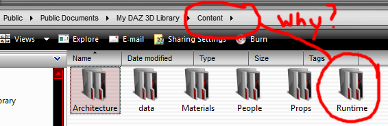

    Finally, the DIM! What a concept! How perfect! How wonderf... nuts. Installing to a Public Folder? What, are they insane? Yes, I know, security issues and blah, blah, blah, make this the easier choice, but, I'm a bit of a security freak. I won't use Facebook, and my daughter thinks I'm a dinosaur for it, but the fact remains that the top Anti-Virus Software manufacturers out there, have specially built software just for Facebook. Can you say Red Flag? But, I digress...
    The upshot of all of this is that I have been moving and rearranging Content on my computer for years, and I really thought I was beyond that (yeah, I'm a dreamer), especially considering the cost of Carrara. I guess I expected a little better than this.
    Don't get me wrong, I love what Carrara can do, I just don't like the way it does it.:shut:
    Carrara should be, first and foremost, able to find, and maintain separation of, the Content that it can and cannot make use of at least as well as Studio, and that's not even 100% but it's a far sight better than Carrara in that respect.
    As to how long I've been using Studio and DIM, It has been many years for Studio, but just the last few months for DIM. I have about 1500 items DIM has installed, and, at least, 200,000 form other sites, but I recently reinstalled, so probably only about 1,000 or so on my computer at this time, so about 2500 items, total right now.
    So I have Content in several locations, and I am willing to go through the chore of moving it again, but the one thing DIM steps all over is the ability to categorize. Every time a file updates, you have to re-categorize it, and I am tired of that. I just want to spend some time enjoying the program, and less time reprogramming...

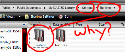

    I do understand and applaud the Runtime Folder and the Content Folder. That's not the issue. As well, I understand that having this in the Program Files was a mistake from day one. I just don't agree with the use of the Public Folder. I am only up to Vista, and I realize that puts me about 3 steps behind the latest OS, so I guess I should catch up on the latest security issues for the Public Folder, but in Vista, its a security nightmare.
    As for the Content and Runtime Folders, they are fine, excellent actually. My issue here is with Content Creators. Individuals, Groups, or Companies, who choose to place their beloved content into a different folder, or don't understand the archivers they use enough to get that content to the right folder. For example: the "V3mertail.bmp" file loads directly into the Runtime Folder, not into Textures, or Templates, just plop, in the Runtime. And there are numerous products ot their that tell you to "extract to the [Runtime or Library Folder]" only to find the files buried in a folder that is duplicate of itself, i.e., Runtime>>Great Stuff>>GreatStuff>>..., or the more annoying Runtime>>User>>Poser>>Runtime>>Joe Schmuckawhack Products>>Great Stuff Working Files>>Great Stuff A32>>Victoria 4.9>>Clothes>>Undergarments>>Panties>>Aiko 3 Shoes by Joe Schmuckawack

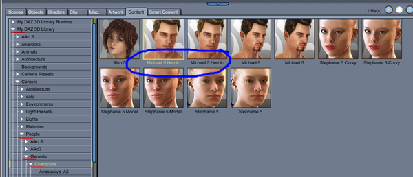

    The main issue, with the Gen 5 characters, I now realize, is that the DIM never loaded them. The Manifest Files are in place, and the Zip Archive Files are there, but DIM isn't loading them for some reason.
    I have done some downsizing, and relocating (to the default folders) and try as I might, DIM isn't loading my Gen 5's. So I, with the help of 7-zip, have installed them manually, but the underlying problem still remains, and I have no idea how to get them installed via DIM.

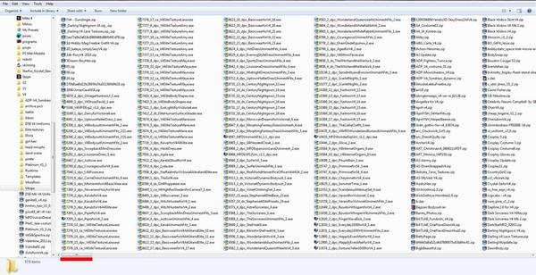

    [EDIT] Just FYI, This is the method I used to get them in place:
    I copy and pasted the files to ...>>New Folder
    Using 7-zip, I extracted these archives into "New Folder" directly, i.e., 'extract here' as opposed to 'extract to...'
    I then copy and pasted the 'Content' folder from ...>>New Folder to C:\Users\Public\Documents\My DAZ 3D Library (default location)
    Now all of my Gen 5's can be found, via Carrara's Browser, in My DAZ 3D Library>>Content>>People>>Genesis>>Characters, which is, I hope, where they are meant to be.
    Now I can't find the Morphs ++ injectors, so I have to load 330 morphs into each character. (hours of work there)

    This is where they are now. (see attached image 001) although ideally, I'd prefer them to be here (see image 002), or at least under this folder.
    Along with that, the image 001 shows two Michael 5 Heroic images, as well as a lot of duplicates in other places. One of these is a DSF and the other is a DUF. Is there any way to make Carrara tell you which is which? I instinctively know that the first is the DSF, since it comes first alphabetically, but isn't there a way to display this?
    This is the DIM default installation directory. So far, I'm planning to use this directory for all of my Genesis products - keep them all, but only them, in one spot. The older D|S "My Library" was my only other spot I used for that stuff, and only that stuff. So, for me, it was a simple case of deleting the folder. The stuff I bought at other stores had nothing to do with Genesis, luckily for me.

  • 3DAGE3DAGE Posts: 3,311
    Hi :)
    The issue of double icons is one of the things which has still to be dealt with in the current beta,.
    The problem is that Daz Studio is rigged to show only DS icons where a product is supplied for both Poser and DS,. and carrara is built to show Poser, DS, and many other content file types, including Carrara's own files.
    One way to eliminate the issue right now,. is to only have one version installed,. preferably the Daz Studio (DUF) version.
    None of the Genesis stuff should be in DSF format,. it should all be in DUF format,.. or Poser CR2.(from the DSON poser versions)
    Is it possible that you've installed the Poser versions,. if so,. those will show up in the smart content browser, but because those are made to be loaded using the Poser DSON converter, ..they wont load into Cararra,. Only the DUF versions will load
    Poser DSON files only open in Poser 9 or Poser Pro 2012,. with the DSON importer plugin.
    My advice would be to uninstal the genesis figures,. (this is now easy to do with DIM).. then check that none of them show up in the Content / smart content browsers,. then re-install only the DS versions of genesis and the gen5 figures.

    Well, I just proved that the Genesis figures require the DSF files in Studio. I ran a search on *.dsf and deleted all of my dsf files to the recycle bin. I then started Studio and Genesis will not load in textured format. All you get are the Bounding Boxes. I then restored all the dsf's to their original location and restarted Studio. The Genesis figure loads as normal. Thus, the dsf's are required for Studio and must be endured in Carrara unless you have no plans for using Genesis in Carrara and no plans for using Studio. Hopefully the Carrara Devs will get it sorted, because its quite distracting to have duplicate figures.
    Hi Staticdrifter :)
    perhaps I've written something badly, or you've picked it up wrong,.. but,... DSF is (Daz Studio Format)
    Carrara 8.5 (BETA) will read and load DUF files. DSF is also DUF or DSON Daz3D formats.
    they're all new,.. and all still confusing.
    you may have two different versions of the products installed,. that would also give you two icons for those products.
    My advice is to Uninstall those genesis products using the "Daz Install Manager" (DIM)
    not by manually selecting and removing files by type.
    Check that they're gone from your program browsers.
    install the Daz Studio version of the Genesis figures.
    Check that the figures show in your programs.
    I think the issue is that you may have installed the Daz Studio versions,.. and the Poser DSON versions,. Both of these will show icons in the carrara browser,. since one product is Daz , and one is Poser CR2 (see pic)
    Having two version installed,. is the only reason you would have two icons showing up
    you'll also notice that the basic male and female are the only doubled icons in that folder. (Installed as an example)
    Also,.. bear in mind that we're all using a Beta version, so it's not fully developed.
    Hope it helps :)
    Ok, I solved the problem (my bad, when I cleaned out the old folders, I left the ini file in there and that caused a major snafu). I have everything loading properly now, at least as proper as DIM can. I kinda want to go along with ManStan on this though. Allowing DIM to load everything still leaves many files in the wrong place. DAZ still doesn't have things in order here, I guess.
    I mean, I have a Library folder with a Runtime folder and a Content folder. Inside the content folder is another Runtime Folder and another Content folder, and inside that is yet another Runtime folder.
    In addition, DIM has provided me with three folders containing Aiko 3 Clothes and four containing Stephanie 3 clothes. The problem here, is that I don't know how the folders are going to load until I tell them to, and If I rearrange the folders to better organize my content, then DIM no longer knows where that content is, so it cannot properly update it.
    My DAZ items, at least the ones DIM will load, number just about 1500 in 131,368 files, contained in 19,632 folders. That's just DAZ products which account for approximately 35% of my currently installed 3D content items. That's a lot of rearranging, and one mistake can set the whole thing on fire.
    I enjoy the speed at which the DIM gets things done, but I wish they would consider adding a feature which lets you set the structure of your Library, Content, and Runtime folders (I know complete autonomy here would be useless, as well as disastrous, but picked from a small list of the most common structures). Then, as it is installing, it could flag, and not install, any content which doesn't match your configuration. Or, it could load those files into a separate Library, which the user can name, allowing you to handle these non-conformist files as you wish. These would not have uninstallers, but that's the way with most, if not all, non-DAZ content anyway, so users would be quite used to that.
    Better still, in addition to the above changes, add in a function that allows the DIM to install non-DAZ content (zip, rar, exe, etc.. from other creators) without uninstallers, but that fit the same structure you chose above, and deals with non-conforming structures in the same manner as outlined above.
    It would not be that big of an add to the current DIM to do something along these lines, because as great as DIM could be if fixed, it could be greater if it could be used for all (well, a great majority of) content.

    Good to see you're getting somewhere,. but if you still have two icons, then you missed something.
    Can you elaborate in that,..
    DIM will only install files to the location you direct it to, whether that's a Content Library or a Runtime folder

    Oh I know what DIM does, but it doesn't do what I can do and that is double check content before install. That is why my runtimes run smoothly and I don't need uninstallers. Zips I unzip, check folders and load to carrara before installing to my runtimes. Installers I install to a dummy folder to do the same thing.
    3DAGE you know as well as I do the DS content folder is a drop it where you like folder structure. Every time I have this sorted and delete all the extraneous folders the next time I install something it's a mess again.
    And I can't get in to my opinion of CMS it would just get this post pulled as my opinion of it has been so many times in the past.
    Now let me show you something that would bring DIM to it's knees, my V4 zips folder; note this is just up to "D". The folder is 7gig.
    800 x 410 - 129K
    Post edited by ManStan on
