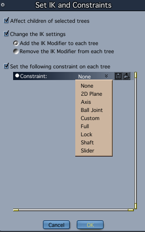

    You can set the IK and constraints all at once by the bone hierarchy tree by going to Animation-->Set IK and Constraints. A dialogue opens with the IK and constraint options.
