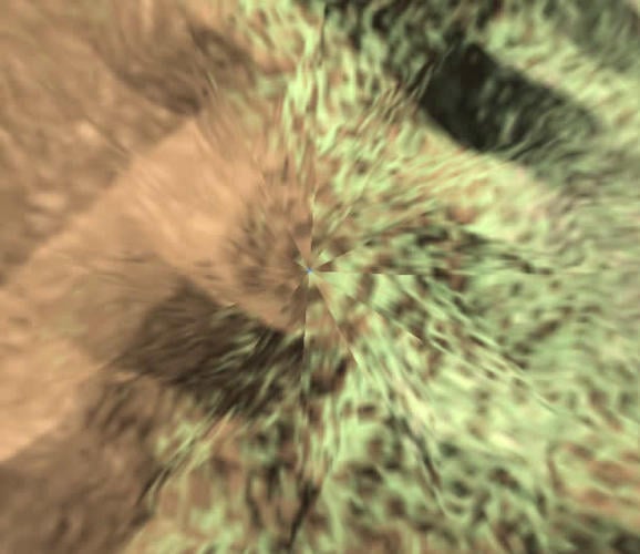

    Here is why I don't use skydomes (attached in the picture you see distortion at the base of the sphere).
    634 x 548 - 28K

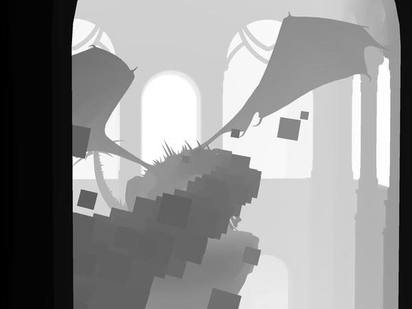

    The second thing I need is the depth information, a black and white image where either white is the closest polygon, and black is the furthest, or the other way around (doesn't really matter the order, it's simple enough to invert the colour values).
    Are these two things possible? If so how?

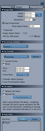

    Can't ell you about the sky box, but in Carrara it's pretty easy to render a depth pass, which is what you describe in your second question. You can add all sorts of render passes. Go to the Render Room, and under Multi-Pass, click add and a window will open with a whole bunch of different options. Select the one you want, click OK and it is added to the list.
    Here's some screen caps and an example:
    2000 x 1500 - 181K
    250 x 720 - 65K
    251 x 295 - 23K
    230 x 741 - 62K

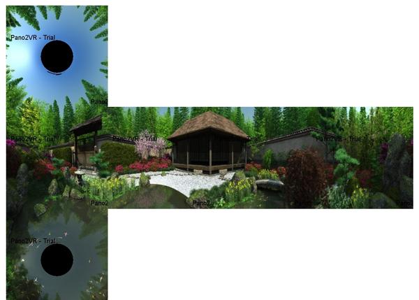

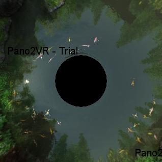

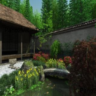

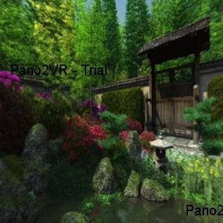

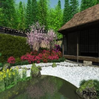

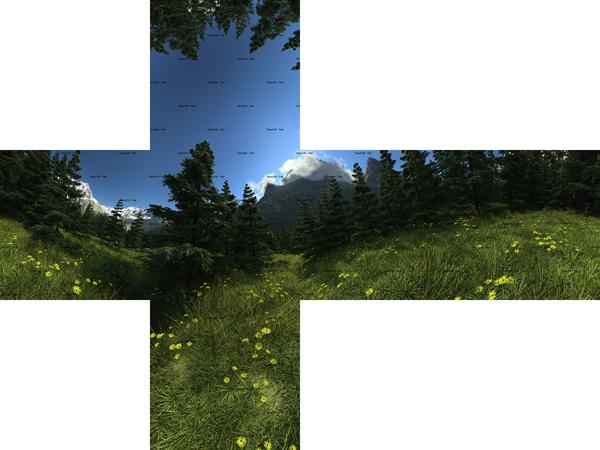

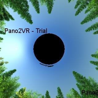

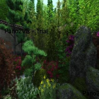

    this is what GardenGnome does watermarked as trial version,
    top bottom next page 5 images forum max
    318 x 318 - 84K
    318 x 318 - 80K
    318 x 318 - 87K
    318 x 318 - 86K
    1000 x 1000 - 529K

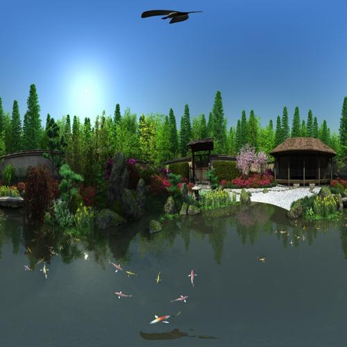

  • WendyLuvsCatzWendyLuvsCatz Posts: 35,005
    actually I missed, it DOES to the cross type too
    2000 x 1500 - 780K
    2000 x 1000 - 949K
    Odd I don't have that, I only have G-buffers, which seam to only work on tiff and photoshop files (awkwardly too, it just doesn't add a new layer, just adds depth values to the alpha channel of the colour layer).
    I haven't seen them called G-Buffers since RayDream! What version of Carrara are you using? Standard or Pro?
