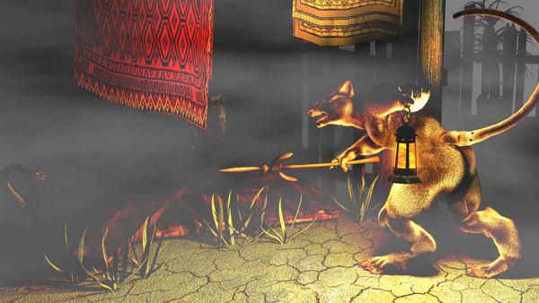

    Thanks! I was just looking for this thread because I figured I'd show what I managed. In the end I did two renders, one with fur/no volumetrics and one without fur/with volumetrics. I used volumetrics pass to get the fog and composited it in post. Well, here it is!

    Thanks. I didn't notice until after uploading it that there appears to be some artifacting in the fog. Not horrible, but noticeable to me. Strange thing is I'm comparing to the original and I'm not seeing the problem. It almost seems like Daz's upload mechanism is re-encoding the jpg and thus reducing quality.
    Wouldn't surprise me. Have you considered .png? I know when I do a screen capture to show something, my Mac defaults to .png and they upload just fine.
    My final renders are always png, but for distribution I use jpg due to the much smaller size. Something to keep in mind though.
    Wow!
    That would really make an excellent D&D module cover! Love the lighting effect on him. The scale of the floor stones, as well as their texture and contrast - it captures that dungeon crawl feel. Gygax would have loved to see this, I bet.
    Wow!
    Thanks for the compliment!
