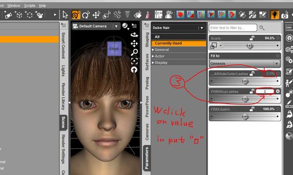

    That's probably because the hair is picking up on the morphs used to shape the head - if that is the issue, go to the Parametrs pane and right-click on its tab, then select Show Hidden Properties; click the Used group to limit the number of morphs showing and you should see the morphs generated by DS in grey; try zeroing those until you find the one that is causing the hair problem (ctrl-z to restore any that are needed to get the hair to fit).
  • edited December 1969
    Thanks. Setting PHMHideOuterLashes to zero fixed it. That's a little easier than what I was doing before.

    Hello. I had the same problem as you guys. However, just setting PHMHideOuterLashes to zero didn't quite fix the problem for me. For me, I had to put FBMJustin, PHMBoyLashes, and PHMHideOuterLashes all to zero percent. I then put FBMJulie to 50.9 percent to resize the hair to the proper size to fit Justin. And, the FBMJulie option didn't show up until after I morphed Genesis to Julie first, and then back to Justin. . . . I just realized while typing this that some readers may not have the Julie character. In that case I suppose you would just have to hand-scale the hair back up to fit.
    Hope this is helpful for at least some people!

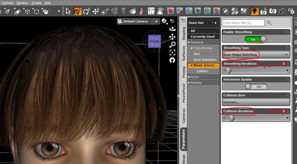

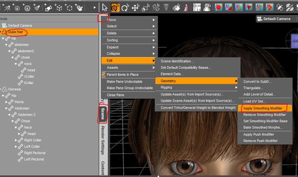

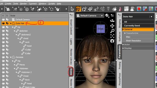

    for other user who will serch and find this topic,
    I record quick 5 step pictures how corrected Duke hair with Justin . (As richard and many guys said already).%-P
    about generated FBMJustin defomation, I hope not touch it, but apply smooth modifier then weak the effect,
    seems best for me
