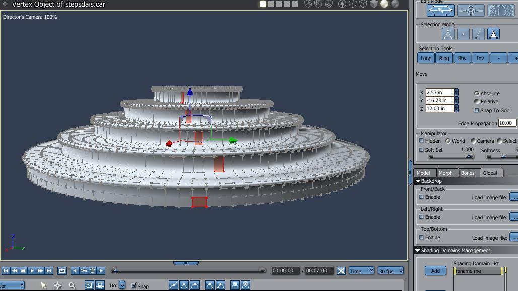

marquis select, only works starting outside the model?
dunno if going crazy.  trying to marquis select center area of my model,
no matter how hard i mash ctrl-key, it moves what i'm clicking on top of
no matter how much i mash down ctrl key, i can't deselect an edge.
if i ctrl-key marquis a single vert, it will deselect, but this method not deselecting an edge.
i made sure selection mode - edge was highligted in the right pane.

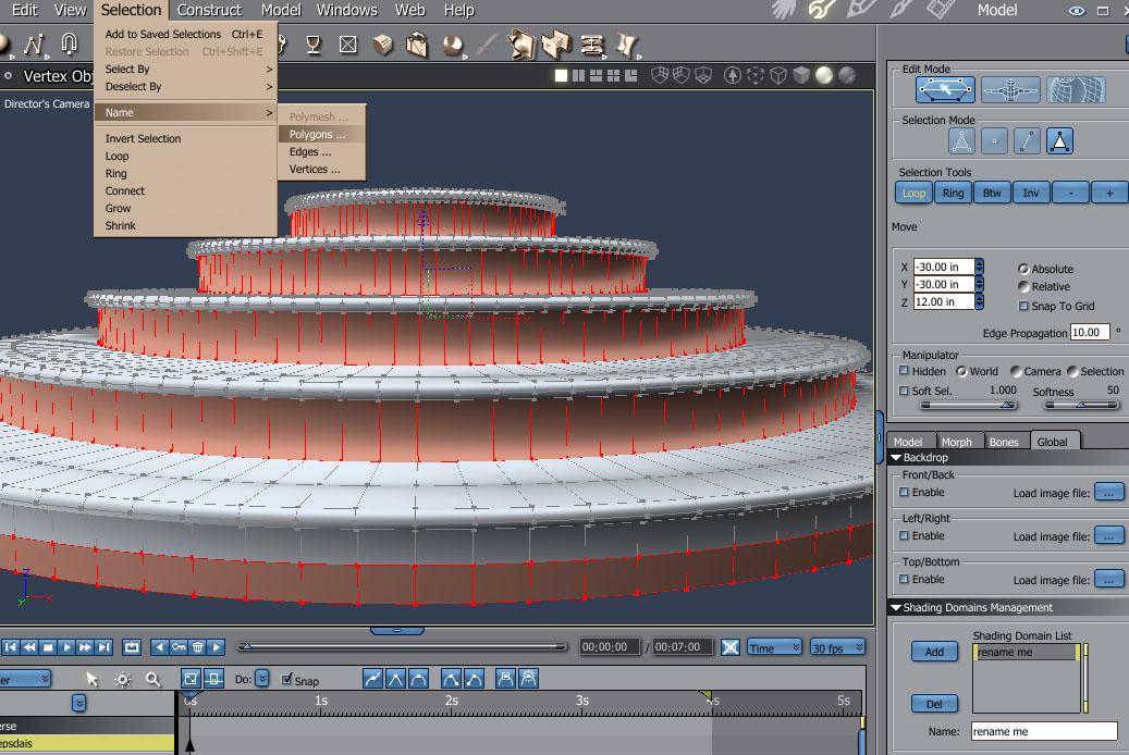

    870 x 418 - 98K
    oh, okay.  figured out the naming box is not connected to the ADD button.
    just highlight the name, thenn type in the lil box

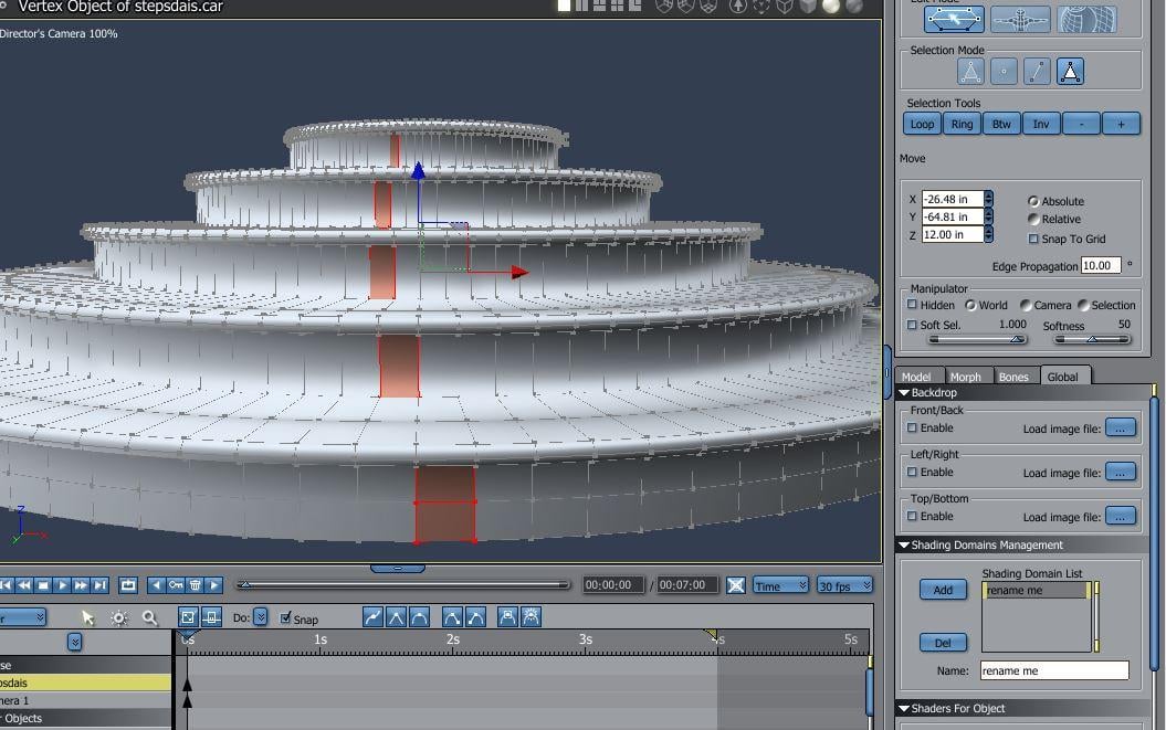

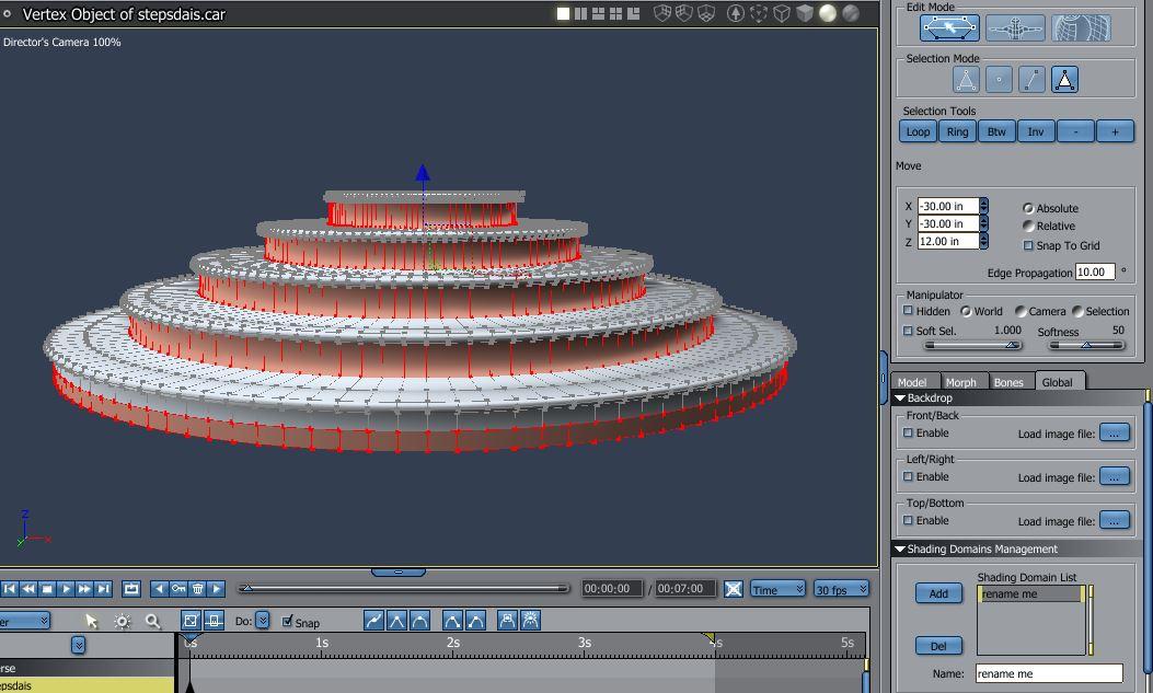

    looping like this works
    looping like this not works as expected.
    can **name selection, for the successful loops
    make a second named selection for that other row i want,
    then Selection, by name, polys - for both.
    **on a side note, opening that naming box, cursor doesn't automatically go there, havta remember to click in the box before typing.
    1028 x 577 - 98K
    1053 x 633 - 115K

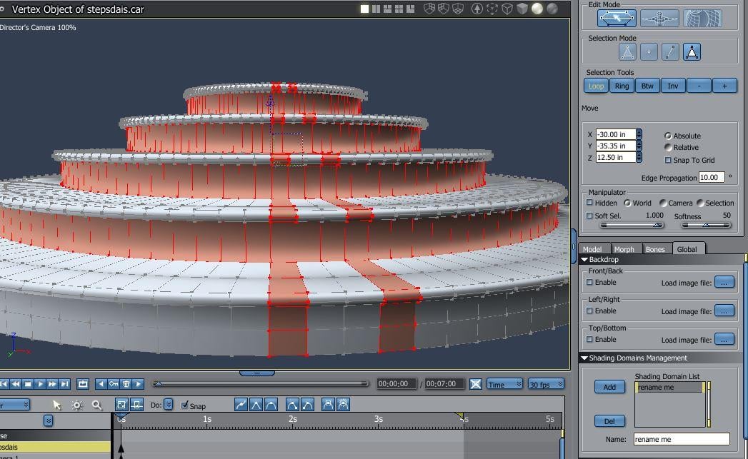

    1055 x 661 - 127K
    1047 x 643 - 130K

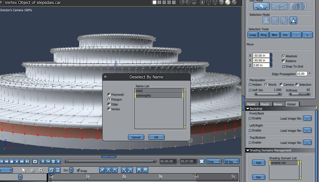

    1037 x 694 - 197K
    1052 x 601 - 116K
