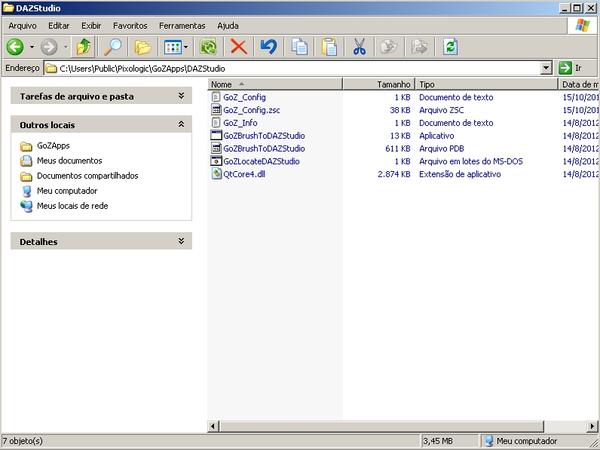

Hello everyone!
As I do to configure the plugin “” version: DS4__1.2.6_Win32 to work in Zbrush4R4?
My version of   is:  .1.6 Win32
When I used the oldest version, .0.114, with the plugin DS4__1.0.3.47_Win32
Zbrush 4.0 old. Did he/she work,  kindness, would anybody know how to explain the one what should do?
In the old version, a paste was created automatically by the plugin of ZBrush in the unit “C” in the following way; C:\User\Public\Pixologic \
- Inside of the paste Pixologic, Apps, Brush, jects.
- In the sub-paste Apps, is other paste, . Inside of this paste they are the following files: _Config.txt, or be;
(PATH = “E:\Arquivos of gramas\\4/.exe”)
- Soon I lower the files _Config.zsc,
- _Info.txt;
NAME = “”
_VERSION = 1
EXTENSION = “. ”
TAMPLATE = ” Completes Binary.”
LOCATE_COMMAND = “Locate.bat”
EDIT_COMMAND = “BrushTo.exe”
- BrushTo (Application)
- BrushTo.PDB
- Locate (I File in lots of MS-DOS)
- QtCore4.dll
They are these the configurations that were. I don’t know as doing an of this since the plugin of ZBrush4R4 is with link broken or inexistent, I continue with the version of the old plugin of ZBrush 4.0.
I think I complicated too much in the question. My sincere excuses, but didn’t I get a shortcut that doubt? At once I thank that it is the hero to decipher this.
Excuses bad English.
My best regards!

Posted: 19 October 2012 07:39 AM   [ Ignore ]   [ # 6 ]
New Member
Avatar
Total Posts:  14
Joined  2012-02-08
Hello Magbhitu!
I contacted with Pixologic informing the problem.
The note that sent me, was the following and gave right;
If you currently have ZBrush 4.0, 4R2 or 4R2b activated on your computer, please deactivate it before installing 4R4. This i done by launching ZBrush and using the Zplugin>Deactivation>Web Deactivation button. To avoid confusion, I also recommend deleting any existing desktop or dock shortcuts before installing 4R4.
If you have version 4R3 installed, you of NOT need to deactivate it before upgrading to 4R4. However, if you intend to uninstall 4R3 I recommend that you of the alone before installing 4R4. Otherwise, GoZ will not work correctly after uninstalling 4R3.
Notice goes PC users: If you plows running Windows XP, OF NOT UPGRADE. Due to advancements in ZBrush, Windows XP i in the longer supported.
I’ve just had Cleverbridge refresh your download link for another 14 days. You’ll receive an email from them within the next few minutes containing both your download link and your serial number to uses goes Web Activation.
NOTICE: The link will still say it i goes an earlier version of ZBrush 4.x but clicking it will deliver the 4R4 stand-alone installer.
After installing 4R4 please run ZUpgrader, found in your 4R4 folder. This will update your installation with adds bug fasten. It’s easiest to of the this before you activate 4R4.
Make a backup or copy the paste Users of your unit C:
Because there I counted the information for Daz to turn with ZBrush.
After obtaining the installation of ZBrush, according to instructions above,
Begin ZBrush, updated version, remember before copying the paste “GoZApps”
inside of C:\Users\Public\Pixologic.
Note: only copy inside of the paste “GoZApps” the paste: DAZStudio.
The files contained in the paste are in the illustration soon above that I posted previously.
Made this, after opening ZBrush, go in preference, seek soon lower for “GoZ and click in it “forces reinstall”. A search will be begun automatically. If he/she has luck, he/she will appear the road of the executable of your DAZ STUDIO. Remember that the plug-in only works with the last version supplied by Daz3D.
I wait to have helped.  Sorry my english.
