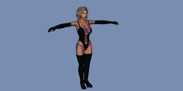

joea64_bdfaa5ca94joea64_bdfaa5ca94 Posts: 296
I've completed my first render in Daz Studio last night, a very experimental, tinker-around, complete-newbie sort of thing, last night using the V4 Leather Teddy and the Portia Hair. I can already identify a couple of issues that I need to learn about/get help on:
1) I need to find some good nude body meshes/mats for Victoria 4. The default bra and panties look weird under garments like this.
2) I need to learn how to manipulate figures' feet in high heels. For some reason, the feet got crooked way forward (you can see it in the final render).
3) I need to learn how to move around clothed limbs so that the limbs don't leave their clothes (or maybe the saved file will allow you to do that? I did save the file, by the way, so I can go back and tinker with it some more.)
Comments very much appreciated. JPG file attached (The original is actually 2700 pixels wide but I had to reduce it to 2000 to post here.)
2000 x 1000 - 130K

    I was looking into some answers but have been called away, I'm really sorry. If I'm able, I'll reply later, if not then hopefully someone else can help.
    But in the meantime, I can say that if you go to your content library, to the folder Daz Studio Formats/My Library/People/Victoria 4/Materials/V4 Sample-Res there's an option there called !All_Natural_NG. If Victoria 4 is selected, double click on !All_Natural_NG and Vicky should lose her bra and pants!
    Secondly, if you make sure Victoria is selected when you double click on a clothing figure, it SHOULD fit itself to Victoria, meaning you can pose Victoria and the clothes will follow. If not, there are manual options on the clothing for "Fit To". If you click that, then select V4 from the list, the same result should occur.
    Got to shoot off now.
    Welcome to the most addictive hobby this side of the law!
  • WilmapWilmap Posts: 2,787
    V4 does come with a texture that does away with the purple bikini.:-)

    OK, here's what's going on. I'm going to attach several renders that are showing the problem, and I have Daz Studio open right now and looking at the Portia hair menu. The first picture (actually, the one on bottom) shows the base figure (with make-up and eyes applied) before the hair is applied. The other four images show front, side and top views of the hair as it's applied (before any tweaking or changing is done).
    Now, here's the problem. There IS no "fit to" option that I can find for the Portia hair!!! This hair appears, when installed, in the in-program menu:
    DAZ Studio Formats -> My Library -> Hair -> AprilYSH
    There's a submenu for presets (color, etc.) as follows:
    DAZ Studio Formats -> My Library -> Hair -> AprilYSH -> Portia Presets
    In this menu, there's an item labeled "Portia !V4", but when I click it after applying the hair, it doesn't work. The fourth image shows what actually happens.
    Again, when I right-click the hair, there is no "fit to" option that appears.

  • niccipbniccipb Posts: 483
    Hi...
    The Portia hair is a "prop" hair, so what you need to do is to "Parent" it to V4's head.
    With V4 in the default pose, Right-Click on the Portia hair in the scene tab and select 'Change Parent' in the context menu. Then in the dialog window that opens find and click on the 'Head' then press Accept. The hair will now be parented to V4's head and move with it.
    Another way is to drag-and-drop the hair to the head of V4 in the scene tab.
    The preset "Portia !V4" that you clicked on is to adjust the shape to fit V4's head. Select the Portia hair and then double-click the preset to adjust the fit.
    Normally when loading hair or clothing in Daz Studio, make sure that you have your figure selected in the scene first. That way clothing and hair will automatically parent or conform to the figure for you.
    Hope this helps... :)

    It certainly did! Took a bit of trial and error, but I followed these steps:
    1) Placed the hair on the figure;
    2) Went to the Scene menu and did "Change Parent" as you instructed;
    3) Ran the Portia V4 preset to fit the hair to the figure.
    The attached files are the result. Now to save this (after adjusting the hair color and some details) as the base figure and move on to clothing. :)

    Now the next question: when I put boots (or other footwear) on the figure, I get a popup message telling me that the preset has values outside the limits for the currently selected item, and asking whether I want to "leave the limits on" or "leave limits on". What does that mean? Also, the default foot position when the footwear goes on doesn't look right, as seen in the image below - you can see that the feet are bent up so that the heels are pointing diagonally. I want to get it set up so that the soles are set on the floor and so are the heels.
    2000 x 1000 - 196K
  • JaderailJaderail Posts: 0
    It means the Out of Limit's would be beyond what the model was designed to do but can be done. It would have moved the feet to the position you wanted at start. You can still go in and POSE the feet yourself. Self Posing is a very important step in 3D art.

    That is known as Poke Thru the fast fix if it works for the image is this.
    Your hand problem: Open your Secene Tab, Expand the V4 and go to the Hands of the V4 use the Eye icon to turn the hand invisible. The poke thru will not show. For places that that can not be done you will need to learn some new stuff. Deformers would be the place to start. That is not to hard but will take time to learn.

    For poke through quick fixes you can also select the item of clothing and on the 'parameters' tab go to scale and size up slightly.
    When scaling up, you might need to 'translate' it in the x, y, or z axis just a touch also.
