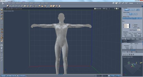

Hi, I was trying to use the model room to make a shirt for gen to be used in daz. The first picture shows I made gen green and saved then opened in carrara, added my basic shirt but when I go the work on the shirt, the gen model and shirt blend together. How do I keep this so I can tell the difference in gen and the shirt which working in the modeling room?  ~ Thanks

You need to set it to Texture Shaded, see image below :

I click that but nothing changed.  Could be because I have gen set as green or because I saved gen as a obj to get it to load in carrara?  I was not sure how to get gen to load in carrara.

Hi Kimber Sue smile
In the assembly room, on the top tool-bar, there are a couple of icons which allow you to edit a model directly in the assembly room.
(See pic) The wrench icon, (to edit the selected object).. and the Hand icon (to stop editing and return to the scene assembly)
Hope it helps smile

The wrench icon works perfect   Thanks
