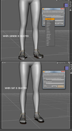

I have Genesis. Now I fit and transfer a bodysuit to it (different polystructure around the foot). Now it has all the bones from Genesis. Now I select the suit and then choose the V4 shoes, and It fits perfectly in preview before the "what figure was it originally designed for" menu appears. But it cannot be applied because it is not a supported item when the menu appears, only Genesis is. So you have to cancel the fitting process. Is it possible to have your clothing items that have been applied to Genesis populated in that list? If so then the shoes can be applied to that instead of Genesis and will wrap around its poly structure. They have Genesis bone structure already since it has been fitted to it, so if the shoes can be applied to a clothing item where the polygons are smooth around the foot IE a bodysuit, then that will solve the issue. But since it can only be applied to Genesis, its a no go. Any thoughts? Will this work if it could be done? It must be done here because the shoes snap into place.

  • BejaymacBejaymac Posts: 1,207
    That list is all of the clone morphs you have installed into Genesis, to get it to work with clothing you would need to create a set of clones for each outfit you intend to use like this.
  • Zev0Zev0 Posts: 5,421
    edited October 2012
    I was thinking just a bodysuit to fit the shoes, and set its opacity to Zero. You wont have to apply this it to all clothing. The suit will be the shoe fitter when ever you use V4 shoes on Genesis. So you wont see the suit, but the shoes are fitted to it..

  • FixmypcmikeFixmypcmike Posts: 17,301
    Fit the shoes to the bodysuit instead of to Genesis.
