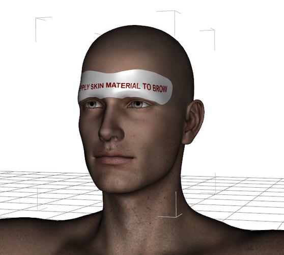

I bought:
http://www.daz3d.com/shop/genesis-eyebrows
And I can’t get it to work (see images).
I select the “apply skin material to brow” and then when I try to apply one of the eyebrows, I get a seethrough skull.
What am I missing here?
Thanks in advance ^^

Make sure you have the brow, not Genesis, head selected. If you click on a fitted item you will usually get the fitted to figure, since that’s what you would pose - either right-click and use the context menu or click in the Scene pane to get the brow.

It looks like you need to select the eyebrow material in the Surfaces tab, and use the Opacity slider to get the effect you want.  Have you tried that?

I am going to try that opacity slider.
When I do select the eyebrow and click a model, I get the edges of the “apply skin material” slightly softened.
I’ll let you know if I figured it out!

Opacity worked like a charm!
Thanks a million :D

If you hide the skin layer by setting the opacity to 0 the product won’t work as that is meant to cover up the texture’s original eyebrows. What you do is:
Apply the figure’s textures to the eyebrow by double-clicking the material preset
Apply the blending transparency map to the base eyebrow, via its preset, to soften the edges where the overlaid textures runs into the base texture
Apply the desired eyebrow type to the eyebrow, which goes on a separate mesh layer over the skin layer.
