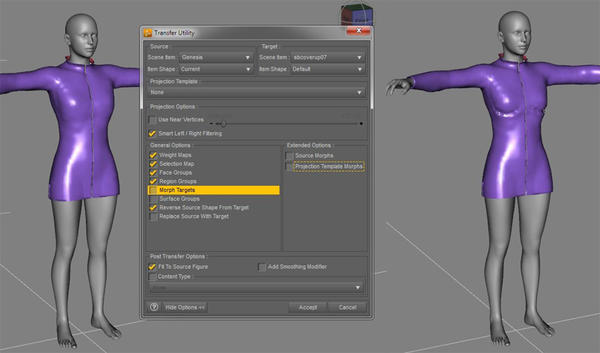

OK… here is an image. On the left is before along with the settings I ‘normally’ use in the transfer utility. I want to to be a loose shirt. It messes up in lots of places but most obviously under the breasts. I have tried about a dozen different things and just don’t seem to be landing on what group of settings I need to use.

After you run the transfer utility, select the clothign in the scene tab, go to the options menu on the same tab (upper right of each tab) and go down to edit and choose Apply Smoothing Modifier.  That should hopefully take care of it.

Yeah, that is my normal procedure, but with this it just gets worse after adding subd and smoothing. I’ve tried most of the projection templates and am not getting anywhere.
I’m seeing some oddities in the projection template area in 4.5. I have duplicates of ‘tight’ and no loose under a number of them, like shirt.
I tried dress knee length… same thing. Bodysuit loose seemed to create an entirely new mesh and I lost about half of my materials in the process.
I did build this over Genesis basic female, like I’ve done many other items. You can see I used the current setting on the source. It’s like the magnetization or whatever you want to call it is reaching out and grabbing the mesh and pulling it in no matter what I try. I’ve done a lot of tight fitting items and get along fine with them but…. no luck with this so far. I may have to start over and build a mesh that fits and then add thickness and pull the outer layer to be loose. Anyway, I was hoping there was something I was missing. I suppose there is always the bones method, but I’m not very good at that yet. My skull seems too thick over in that area. wink

Hi dumorian…
dumorian - 28 September 2012 09:55 PM
The reason you have duplicate templates is that you have both the old .dsf and the new .duf projection templates in the Projection Templates folder
data/DAZ 3D/Genesis/Base/Projection Templates/
They re-did the templates and renamed some of them. Just delete the .dsf templates.
This is what you should have -

The Dress Knee Length template is a tight upper body suit and that’s why your loose dress shrinks down around the torso.
Body Suit Loose is like a pair of over-sized coveralls and will distort the skirt part.
Have you tried with “no” projection template?
Hope this helps… smile

Thank You! I ridded myself of those projection dufs and all is well on the duplicates.
