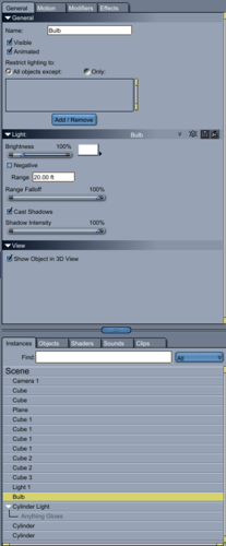

I have finally started to look more in to lighting for my scenes and how better to illuminate them! wink
I cant seem to get rid of the jagged lines that you see on the wall to the left of the screen and the other side of the light! I was hoping for a cleaner `line` / fall off but not sure if this is an error in the way Carrara calculates lighting or a user error raspberry
I have a basic cylinder (with anything glows) and a red glass material, also the color red in the glow channel, with aura enabled. I have two smaller cylinders either end with a metal shader on them. Ambient light set to 0%.
This is being done in 8.1.1.12 Pro (64bit)..
Any advice to get rid of those jagged edges would be great please ?
Thank you smile
EDIT: Sorry, forgot to mention the `Bulbs` in the scene.. Settings for that attached also smile
My guess is that its some thing to do with how light travels through/round the geometry of the `caps` at each end of the tube light???

This is partly due to the way Anything glows works,..
creates light sources per facet / vertex/ bounding box.
and partly due to the way you’ve built the Light model and fittings.
Cylinder “primitives” have many more edges and Tri’s than you really need for this, and the ends of the cylinder will also be effected by Anything glows, and since the End caps, are right next to the “Bulb” ends, you’ll get issues with shadows.
You could make a single cylinder with some divisions, and make the Middle section a separate shading domain (with glow) while the ends sections are just a simple metal shader.
then only the shading domain with glow (the bulb section) should be effected by the Anything glows light.
If you’re using anything glows lights, you don’t necessarily need to have Indirect light enabled in the renderer.
AG should cast light,...
Glowing objects require Indirect light enabled,.. to emit light. (See pic)

Played around with excluding the “metal” caps from the Anything Glows light, or switching them off throwing shadows. This didn’t help, but I stumbled upon a mistake in my scene. There are three cylinders with the same name, “Cylinder”. I had the Anything Glows set to just “Cylinder” without thinking that it now had are three to chose from. Obviously it took the one near the wall, and that resulted in the black spot. Naming all three differently, and setting the Anything Glows correcly to the tube instead of a cap, resulted in an unperturbed rendering, using your settings.

I took your advice (3Dage) and re made the `Bulb` tube light as one single mesh with two shader domains smile
As you can see, it worked a charm and I am pleased with the results smile
I cant seem to get the light to go above 200 (Red Anything glows light) but will try to use a lighter red in for the glow color as it seems a little dull to me!
