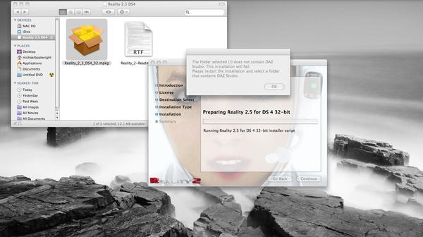

Just finished installing DS 4.5 (32 Mac). Now I’ll preface this by saying I’ve been using DAZ Studio since 1.2. So I’m not exactly a newbie. But this has got me stumped and was wondering if this has happened to anyone else. I purchased Reality 2 for DS4 (32) and went to install it into DS4 but received this Error Message: (see below). Does anyone know what is going on here? I’m at a loss! Thanks for any input.

From the error message, it looks as if you simply clicked the icon of your startup disk (‘MAC HD’) when the installer asked you to select a destination.
This will not work. The Reality installer needs you to find the actual folder that contains DS4.
Go back to the Destination Select step and look for a button that will allow you to choose where the software is to be installed. Click that button (I forget what it’s called, but it should be more or less obvious) and a file dialog will come up. Use that to navigate to the folder where DS4 is installed. Choose that folder as the destination for the installer.
Once you’ve done that, Reality should install without problems.

Thanks for that, but if I don’t click on the start up disc I won’t get the “Choose Folder” option.
