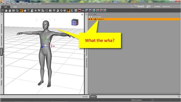

I’ve filed a bug report on this, but wondering if anyone else can check Amarseda hair for me please. It loads entirely invisible in DS4.5 - might as well not be in the scene!
Has anyone had this with other hair and know what causes the problem?

When loading the Amarseda DAZ file in DS 4.5, it shows up in the Scene tab, but not in the viewport. If I hover the cursor over the viewport where the hair should be, I see the hair highlight in orange, just like any visible element does when the cursor hovers over it. However, If I select the hair in the scene tab, and look at the Surfaces tab, everything looks OK - diffuse, opacity, etc. If I apply another material preset, still nothing shows in the viewport. If I load an old 4.0 DAZ scene that used the hair, the hair shows up just fine in the viewport. I think something must have changed in DS 4.5 to make the old DAZ file incompatible.
I installed the Poser version of Amarseda hair to see if it works, since the DS version does not work. The Poser CR2 file works fine. So my workaround is to use the Poser CR2 file and then apply the DS material presets.

Dug my copy out of the moth balls, the daz files were done on DS1.4 (2006), so the file “data\aprilyshAmarseda_53239\neck\aprilyshAmarseda_53239_neck\maps\uv.dsv” can only be read by DS1 or DS2 as the scripting language changed with DS3.
The result of this is that with no UV coordinates for the mesh, all you get is the first pixel at the top left of each image map applied over the entire mesh, and as that’s a black pixel on the transmap you get an invisible mesh.

By golly you’re right! The file loads fine in DS3, so I suppose those of us who paid for the product and the software can reasonably expect an update to make it work in DS4.5 right?
