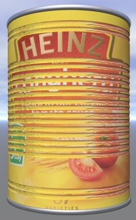

I can’t believe I can’t do this, I’ve done it before.
I have a tin can with grooves / indentations in it.
Made with a positive cylinder and negative torus’s.
When they are grouped together they make a single cylinder with the grooves in it.
All I want to do is to map the label around the tin and into the groves.
I tell it to map it cylindrically which it does, but when I look at it, it looks like it is
mapping a complete copy of the label in to all the separate grooves and a complete
label on the tin as if they were separate objects. What am I doing wrong?
Any help / advice would be greatly appreciated.

It looks for me it might have something to do with the grooves being negative booleans and having turned on option ‘transfer material of negative boolean’. It should be turned off.

I thought the same but I had already turned it off when I checked.

dumb question does it work if you convert to a mesh?

@ gaffer2. -  Yes it’s the same when converted to a mesh.

What happens if you set the material on your negative toruses to 100% transparent and click to blend transparency.

It has to be converted to a mesh, exported, and then re-imported before it truly becomes a single mesh. Before exporting all of the individual mesh’s parts are still stored in memory (in case you decide to undo the conversion action). Once you get it re-imported you probably need to use Object Side or something to map it successfully.

Converting to a mesh exporting and importing may work, but geometry resolution will be lost.  Likewise modelling in Wings3D could be a way.
Here I’ve provided a material solution.
The tin geometry, the cut cylinder is set to be a lens material with 0 refraction, this can have reflection or diffuse to interact with light to show off the geometry.
Inside is your label on another cylinder – this shows up through the lens.
It’s not perfect, but it is interesting.

chohole - 11 September 2012 05:48 AM
They cut into the tin leaving it in slices.  I can see what you are thinking here.  This is a far more difficult problem that it at first appears…  You’d think there was an easy way to get around this… but… nothing springs to mind.

OK, I had another idea.  Bump mapping.
How does that look?

Yeah thinking about it, that would only work if the cylinder was a solid chunk and not hollow. I got something similar to work on a terrain because I had it set to solid.

Even using one of Rashad’s additional primitives with set to solid when boolean rendering.  It still did this to me.

Thanks again David. That looks like what I was after.
Never thought of doing it that way. Still learning.
