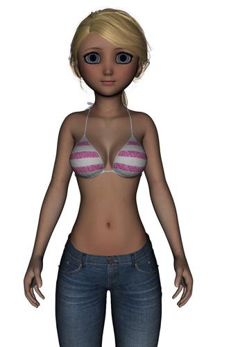

I am a big fan of Genesis and the ability to transfer V4’s clothes to it via the Transfer Utility.  I have had almost zero trouble doing it with any model I have, the clothes convert to Genesis very well, the morphs usually work, and it is usually pretty awesome.  (I should add I use Daz Sudio 4.0, I am not going to be taking the plunge into 4.5 any time soon.)
I have, however, had trouble with ONE clothing item, a very popular one called Cutoff Jeanz you can get elsewhere.  I have full-length “Jeanz” from the same vendor that transfer with no trouble, but I get a weird result from the “cutoff” version.
Take a look.  This is Genesis turned into Hitomi, wearing Hong Yu’s bikini top, and the full length Jeanz:

Both garments were converted to Genesis by selecting the garment in the scene tab.  Then I went:
Edit > Convert to Weight Mapping and then I selected Triax weight mapping.
After that, I selected Assets >  Transfer   and for the source “scene item” I pick Genesis, for “item shape” I pick “clone” and then “victoria 4.”  For the target “scene item” I pick the name of the garment, and then under “show options” I select “reverse source shape from target”
