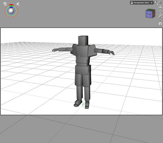

So yeah, I create a new scene, add genesis, save, exit, reload, and this is what I end up with:
http://toykat.com/img/wtf.jpg

Looks as if it is not finding the content - please open your Content Directory Manager (Edit>Preferences>Content Library), expand the current set and then the entries under DAZ Studio, Poser and other formats, and take a screenshot - then post it here. Also please tell which operating system you are using.

I looked a bit at the log, and found this:
Edit: Added a space between % and 20 to try and avoid auto-unescape… The Space between % and 20 is NOT in the log files
WARNING: fileinput\dzassetdaz.cpp(1677): Could not find geometry definition: /data/DAZ% 203D/Genesis/Base/Genesis.dsf#geometry.
Notice anything “off”? (Also, this isn’t the only line that has a warning like that - Looking at the filesystem (Assuming /data is “rooted” in M:/DAZ/DS4PointFive (See below), the files DO exist (That is, the semi-unescaped version of that string)) - I’m assuming the #geometry is just a nice way of telling me that it’s looking for “geometry” inside the file.
Unless there’s some obscure formatting going on in the log, I think “DAZ 3D” might be misinterpreted as “DAZ”% 203"D” and not “DAZ”% 20"3D” by whatever is reading it…
