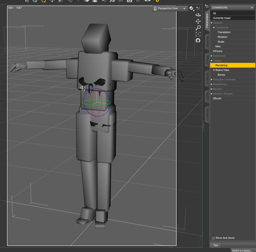

Yesterday I started with a Scene .. nothing huge .. just Victoria4 and some Clothing ..
I think this is really a bug .. the Clothes are shown .. but I get victoria like I changed the display for geometrie but I did´nt ..
Anny Helpers out there .. or did I something wrong ??
Thanks a lot for your Help
Tobias

This happened to me with Genesis set to V4, are you loading same?
I resolved my issue by re-installing Genesis starters essentials..it appeared that before doing this DS4.5 wouldn’t recognise or list Genesis, and therefore any Genesis character selected loaded as bounding geometry.
So, I would suggest that you try re-installing the character from your saved downloads, or re-set your downloads for the item in your DAZ3D account, and then re-install.

Maybe you changed the Drawstyle of your tool to “Smooth-Shaded box”. If so, set it back to “Off”
