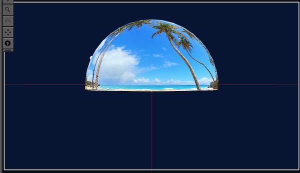

the UberEnvironment light comprises an environment sphere
on the net there's panoramic photos which when applied to such a sphere give you a great all-around backdrop for your renders
notably the high quality images found here: http://www.hdrlabs.com/sibl/archive.html
the keyword to find suitable images is "equirectangular"
add a uberenvironment light to your scene
in the scene tab, expand the uberenvironment node
select the environment sphere
in the parameters tab, unlock everything
change the settings so that the sphere is selectable and visible-in-renders
in the surfaces tab, of the sphere change the diffuse color to an equirectangular image
set the ambient color to white, depending on the render type you may have to reduce ambient strength
( other panoramic images can be made to work with a little tweaking
already you can make great renders

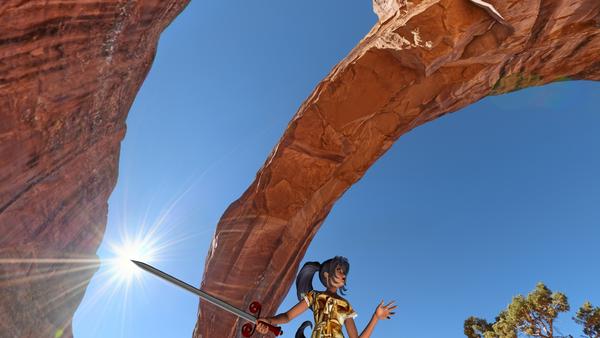

but your character is in the center of a huge sphere, so it cant cast shadows on what you perceive as the ground level
also when your camera moves around you can see there's something wrong the illusion is broken,
the character - is not attached to a ground position at all

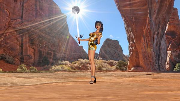

so lets bring the ground to shoe level
select the sphere
create a d-form
scale the d-form field X and Z scale to 10000%
move the d-form field down to select only the lower half vertices of the sphere
scale the d-form node along the Y axis to 10 or 5 or 0 %
there, the sphere is now flat bottomed !
you could export this as an obj file
you could scale it along the Y Axis by -100% and therefore hide the dome below ground level
you could have 1 image for the dome and 1 image for the ground

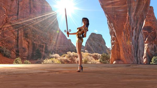

    I made one of those in Carrara last year
    I called it a flatarsed panodome©
    (copyright on MY name not the concept :lol: )
    was a bit of a joke as somebody claimed he invented the concept on another forum and others chipped in that cycloramas and skyboxes had been around in one form or another for yonks.
    setting it to receive not cast shadows is the other step, not sure in studio though as there you can only do both I think.
    in DS there's a "cast shadow" property for each node
    so in this example i have a distant light casting shadows but not blocked by the sphere
    in blender i can use the image as a sky-light
    but i can also set the painted sphere as an emitter
    this way i'm sure the orientation is like what i set up in daz studio
    in the end the ideal shape of the dome would be, flat up to the tree line, then a cylinder from the bottom to the top of the tree/buildings, then a sphere (or a plane?) for the sky
