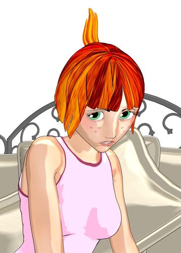

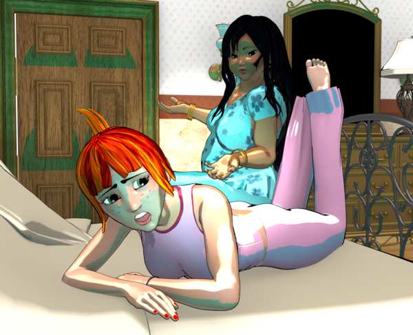

What once rendered like example 1 is now rendering like example 2.
I have no idea why!
The scene is one I have saved that has made many good comic pages with no weirdness in the past. Only two things have happened. the usual updates and I upgraded my Daz4 to the latest. Just. Argh!!
Anybody got any clues on this mess? Please? (whine)

    Okay it's not a green lay. It's blue. It's like it's putting blue everywhere. I've tweaked, prodded, rebooted, and I don't know what else to do. It does it with both the cartoon render engine and 3delight. Anybody??

    If that happens only with the Toon shader it is the shader picking up the blue as the shadowing color when it does the color reduction. No Idea how to get around that as I do not toon shade at all. Should be able to fix that I would think.

    Okay Got it. I get the BLUE green effect now. And guess what adds it? UE2. Any setting, Ambient or other... No UE2 light and no bad shadow effect... I hope this helps you some...
