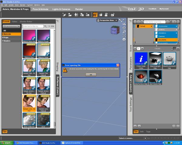

Hi, as i said in the title...i get this error and i don't know how to fix it, i downloaded the two genesis packages and let the manager autoinstall them, and they show up with the thumbnails within daz studio but when i try to load them...well the error shows up..

    If it says Material at top-right it's a setting file, that needs the figure loaded and selected - go to DAZ Studio Formats>My Library(or My DAZ 3d Library)>People>Genesis in the Content Library, on the right in your image, and double click the Genesis file 9which should be marked Actor at top-right), then use the material file.
