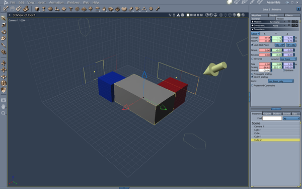

I have a vertex object, that is part of a larger scene, started as simple cube, resized, positioned correctly, converted to vertex object and modeled some more. As I scaled x,y,z axes by different value now I have object that looks different in the scene compared to what I get in the editor. Is there a way to "reset" or normalise the dimensions, so it looks exactly the same in the scene, but it is not scaled anymore and the dimensions (aspect ratios) are the same in the editor ?
Added two screenshots to make my point clear. I want the grey object in the middle to have the same shape in the editor as it has a in the scene, i.e to be block with various dimensions rather than cube.
So I would like the size of the object to stay the same (2.08,3.84,1.52 in my example) but the scaling to be 100% on all axis and this to be reflected in the editor.

    Open the object in the vertex editor, Select All (Ctrl-A), select the scale tool and you can either visually re-scale the object to your chosen dimensions, or you can use the parameter boxes on the right hand panel to enter your dimensions precisely. When you go back to the Assemble room, be sure to reset the scaling to 100% so that you are not double applying it!

    Thanks, this is what I wanted to achieve. I was looking for more instant solution, as this is bit tedious if you have a large number of object that need this treatment, but it is certainly a way to go.
