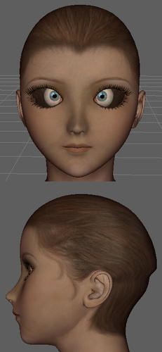

I've just installed Aiko 4 Base in a separate runtime which I use for both DS 4.6 -32 (XP) and Poser, but her head looks weird in DS (no problems in Poser). V4 is installed there too, but she looks OK. Any idea what can be causing this?

    I had that problem years ago, and it was caused by having more than one version of V4 installed.
    Makes sure that you only have one V4 installed, and it will work OK.
  • Richard HaseltineRichard Haseltine Posts: 39,536
    In particular, it's duplicate \Runtime\Libraries\!DAZ\Victoria 4 folders that can cause the issue.
  • TaozTaoz Posts: 4,858
    edited September 2013
    Yep, I actually had two V4, one in the DAZ library and one in the runtime shared by DS and Poser. Removing one of them fixed the problem.
