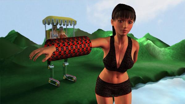

mcjShrinkWrapA for DS 4.5+ - shrink wrap figures and objects -- simple basic version A
mCasualmCasual Posts: 3,802
edited July 2013 in Freebies
this evening i'll quickly cook up a script which uses the services of the free mcjCollider
plugin to shrink wrap tubes around figures and objects -- eventually i'll post a version
that can also make "spandex" effects
it's ready ! https://sites.google.com/site/mcasualsdazscripts3/mcjshrinkwrapa
but the manual / web page will be expanded to cover the different ways to use the script

    half way there i just have to make sense of transforms ... since i allow the tube to be scaled moved and rotated before the shrink operation

    yay it works
    i just have to add the option to set the minimal distance from the wrapped object
    in this case it was 0, but i dialed the shrink-wrap-morph strength to 98%
    figure 2 : 2mm gap
    1280 x 720 - 460K

    here is the way it works
    the script goes through the wrapper cloth's vertices one by one.
    each vertex has a "normal" which is like a flagpole planted perpendicular to the "ground" at the position of the vertex
    the script installs an mcjCollider at the top of the flagpole
    it orients the mcjCollider so that it points toward the ground, in line with the flagpole
    the script "fires" the mcjCollider
    the collider crashes at the surface of the figure being wrapped
    the script adds an entry in the morph that makes the cloth vertex move just above to the crash site
    if the collider misses the figure, for example while trying to wrap 2 legs,
    then the script moves the cloth vertex the sane distance it did, the last time it did hit something.
    The result of this is not optimal but often better than just leaving the vertex alone
