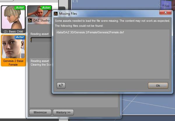

I tried installing the Genesis 2 figure through the Install Manager but when I click on the icon in the Figures menu I get an error that was the same as what happens when I click on the Dragon one.

    You need to look at how your folders are setup in the Content Directory Manager.
    It looks like DS can't find the 'data' fodler which holds the Genesis2 stuff. Where did DIM install the Genesis2 Starter Eseentials into, and is it listed in the Contetn Directory Manager as a DAZ Studio Formats folder? If is isn't, then that is your problem.

    Did you use DIM to install Genesis 2? If so, where did it install the content into?
    If you didn't use DIM, and installed it yourself, you may have put the folder called 'Content' into your DAZ folder, and you shouldn't do that.
    DIM ionstalls to a folder called My DAZ 3D Library in the Public Documents area by default (unless you change it). If you are using DIM, go to the installed tab, find Genesis 2, select it, and right click, then select Installed Files. That will tell you where DIM put them.
