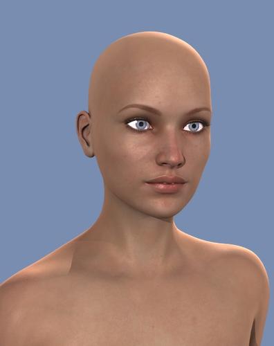

Okay... so I was just told that Diffuse and SubSurface Strength on any shader in 3DL should always add up to 100% for it to work as it is supposed to...
Is this true? I'm looking at a render of Bree, the only thing I changed was dialing down the diffuse to 50% (because the SSS was at 50% in the default...) and I'm a little... unclear as to why I would be told this...
Oh, I only did it to the skin, Lips through Toenails..
477 x 603 - 95K
Post edited by wancow on

  • Richard HaseltineRichard Haseltine Posts: 40,375
    Well, there's the idea that if you are trying to be physically correct, or even plausible, the outgoing light (specularity+diffuse+SSS) should not exceed the incoming light, which would be the case if their strengths added up to 100% (or even a bit less, since some light is lost - absorbed and remitted as heat).

    The math is beginning to make my head spin... unless it's not based on incoming light and only based on what's reflected... So If I set everything at 33.3, Diff, Spec and SSS I would be "correct?"
    Let me just add this: I have never seen light coming through the ear the way I see on some renders. I don't know how to even get that...

    Due tothe physical law of Conservation of Energy, (diffuse+specular+sss ) = 100% total. Bowing to richard, SSS ought to take the absorption into effect.
    This ain't the real world.
    Would it be nice if the shader, somewhere, took this into account and did the balance for us? Yes.
    Are the results accurate? Well, no not really.
    SSS is actually a much larger part of the visual appearance of many things, human skin being a particular example of where it is very important. Diffuse reflectance is actually pretty damn low on the percentage of what we actually see. But what we have here in Studio and other renderers is not a physically accurate representation: its a best guess, an approximation, a replica.
    This is also ART. Some of it really OUGHT to be up to the eye of the artist, attempts at photo realism somewhat to the side.
    Until Studio has a shader like ezSkin (yes, I know, its not a shader per se; but you know what it does have: conservation of energy built in, or at least an approximation there of), Studio is going to be more on the artistic interpretation side and less on the realism side.

    No, that would not be correct.
    To be "correct" your diffuse would need to be way down (this number 0f 6% sticks in my head from something i read, but I may be wrong), with specular somewhere above that and the majority of it coming from SSS.
    If you use the US2 shader, you might be able to get some backscatter, I have not tested it; but there is a backscatter boost built in. I find it unlikely that you are going to see much backscatter with other shaders without a serious sss map (and I don't it even then).

    That's not quite accurate. SSS is the PRIMARY factor in what you see when you look at human skin. Diffuse reflectance and specularity are minimal in comparison.
    in your brief mention of these maps... well yes, to be truly accurate you are going to need all of those and probably more, and all of those that you mention would be involved in sss calculations: oil would apply more to specularity, but if its reflected by the oil is not going to penetrate and scatter, the dermis is going to absorb some and reflect some and some will penetrate (we are talking about light here) and the same with subdermal (though this is where a lot of the scattering happens).
    I have begun to truly realize what an awesome process this is, and it does not surprise me in the least that we are not able to simulate it casually.
