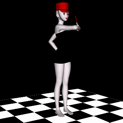

figure 1, our animated fairy and her wand ( i.e. our animated particle emitter )
so we want our 50 sparkles to be emitted ( and maybe we'll re-use some )
the rate of emission should be zero for a while, ramp up, sustained flow, ramp down, zero
an individual sparkle life cycle will be .... not sure yet
400 x 400 - 337K
