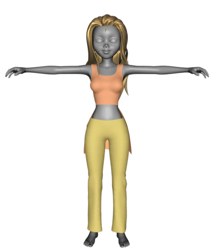

This is my first self made outfit, and I'm excited to have another freebie to offer back to the community! I am a newbie so please give me feedback so I may learn and grow. It imports as one object but will separate if that's easier for you guys, just let me know if you want it separate so I can re-post. Daz4 users use transfer utility after import

    The file that you have uploaded is an OBJ with a MTL file. It cannot be conforming, as it is not rigged. You would need to load the pants and top seperately into DAZ Studio, and rig them for Genesis. There is a lot more work to do before these can be used in DS.
    There are many threads on the forums here on how to do that, but you could ask in the New Users Forum, or look for threads by wilmap and Patience55, and there are several tutorials on ShareCG by Patience55 on how to do this.

    I'm going to clear up a few things. I made this in Marvelous Designer 2 (designed to Genesis Figure) and it exports as conforming. This was the first I have made but I have several skirts and a few shirts as well and they all conform to the Genesis Figure, including if you apply morphs, after you run the transfer utility to fit it to Genesis. Again I am a beginner so please all Intermediate & Expert designers bare with me, I am just trying to give back after all I've been handed down from the Daz community. I am open to receiving tutorials if you guys have any or just paste a link for me to learn.

    An obj file is not conforming, it has to be rigged.

    In the Poserverse (that's were you are BTW) for something to be conforming it has to be a figure, and to be a figure it's needs to be rigged with a skeleton, what you have supplied is a static prop rather than a conformer.
    Oh and using the Transfer Utility is just the starting point of rigging content for Genesis, and definitely not the end point.

    I wouldn't bet on it Wendy, I've just looked at the mesh, it will fall apart in Posers cloth room.
    1) When making content for Genesis you NEED to built it around the default shape and not around a morphed shape like you have.
    2) Having a two piece outfit in one OBJ will cause problems when rigging especially when they overlap like yours does.
    3) If you want to make content for this universe then get a 3D modelling program, rather than using a pile of crap like MD or Optitex as neither of those systems creates a very good mesh.

    Getting clothing from things like MD to work right is a problem for most, but for someone like me who makes his own content it doesn't take too long to get things to work half decent in DS. The attached pic is your outfit conformed and rigged to Genesis, to get it like that I dialed up the basic female morph in Genesis, then I used the Transfer Utility to reverse the source shape, the result of that was an outfit with a lot of wrinkles in it, so I applied a smoothing modifier, set it to Generic and the smoothing to 30 to get rid of them, I then "baked" the smoothing modifier and exported the smoothed mesh as a new OBJ. After deleting the old outfit from the scene I then imported the OBJ I just made, and rigged it with the Transfer Utility, I also used your mesh as a Morph Target to create the Basic female morph, and smoothed and baked it for a better finish.
    Would be better if I was to split the top from the pants and have them as separate items, but it's not too bad for 10 minutes work.

    did fit quite nice using bodysuit in transfer utility with smoothing modifier
    will grab some links for saving as clothing asset

    Wendy I wouldn't bother, go check the UV mapping, that needs to be fixed before this outfit is worth rigging.

    First, i'll start by saying thank you for sharing!! It takes bravery to share a freebie the first time, especially when comments can be mean instead of encouraging! No fun!
    So here's a ton of HURRRRRRRRRRRRRRAAAAAAAAAAAAAAAAAAAAAHHHHHHHHHHHH for you :)
    I don't know much bout MD, except that its crazy expensive....haha!
    People obviously have different views about what is good or 'crap' (I personally love optitex stuff.... sad that Optitex reneged, but major kudos to Martin who still works hard to keep making dynamics all on his own!) If you find something that works for you, sure! It just matters that you like what you're doing.:)
    If you model for genesis though, keep in mind that to rig clothes for Genesis, clothing needs to be made to fit the BASE default genesis shape. If you create clothes for Genesis, I could help you rig them. This particular suit was easy. I split them up, rigged the back of the top as a skirt, and auto rigged the pants. I put shaders on them and it worked wonderfully. :)
    Hey, i can rig things now, but i can't model much. So we all learn different things in different orders
    Don't let this get you down! :) Great work, it just needs a few more steps to make it a finished clothing item to use in Daz Studio or Poser. :)

    I always model my clothing on Genesis base, even those I have made in MD. Most of those I had done using the female shape didn't transfer well enough, and were not very smooth under the bust area.
    I will download the item and let you know what I think.
    Good luck with your modelling, I know how daunting it is when you first start to give away free items you have made. Don't give up!!:-):-)
  • WilmapWilmap Posts: 2,765
    edited April 2013
    Well I had to re-UV map the textures first, but I loaded the object into Daz at 100% and it came in the correct size!
    I then shaped Genesis to basic female and ran the transfer utility and it worked fine. Shaped Genesis to V4 and apart from the bust not being as smooth as I would have liked, it was OK.
    Just one problem area, and I find this in a lot of MD clothing - the back has a large ruck which need smoothing out in a modelling program.
    Otherwise a good first attempt.:-)
