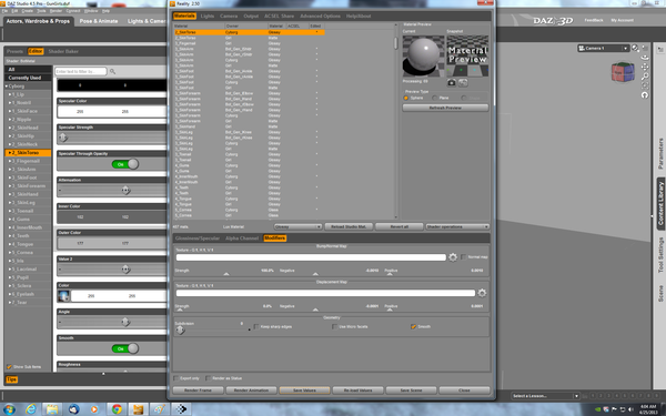

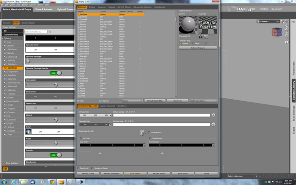

Does anyone have any tips for using the Bot Genesis figure with Reality? I can't for the life of me figure out how to get the metalic skin to come out correctly in Reality. Here is a few attachments, first off with Daz Studio render, it looks quite nice! For some reason though, in Reality it comes out completely white.... There are some metalic looking parts, but not much (I noticed the back leg is reflective..), the spine lights are also dull and barely there. I added a small, very dull blue light on the head just for fun to make it look as if the light near the ear is dimmly lighting up that area. In DAZ, the spine's lights are reflecting off ever-so-softly (which is what I want... Them to be visible, but very subtle).
Any advice would be appreciated, especially if you've used this figure in Reality, if you could let me know how you got it to look right. I let the reality version render for just a short time (you can already see it looks like white plastic, mostly).

    The inconsistent vertex winding means you have a material with mad geometry, which may be the low-rez bugged geometry getting exported. You get this when you enable subdivision (or have a displacement map, which implies a minimum of one level of subdivision in LuxRender) and have a bad mesh. If it's a displacement map and you can't fix the offending mesh, then switching to microfacet displacement will work around this, but render quite a bit slower. But again, I don't recall having problems with BotGenesis' mesh subdividing. If you scroll back in the LuxRender log, you can see where it loads shape 566 and determine exactly what surface has the bad mesh.

    The material for the Bot Genesis is a custom made shader for the 3Delight render engine & would require extensive tweaking to get it to look good in Lux Render. You might want to try using a different metal shader.

    The material is set to glossy, which is why it doesn't look so great. If you convert it to a metal and use one of the Reality presets (aluminium works well) you can give the entire body a metallic sheen.
