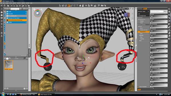

So I am now blerry eyed from trying to figure this out on my own help!! Everytime I add Akio4 or 5 and Sadie to my character the hat gets wonky on the ends of the tails….... and I can’t figure out how to fix it anybody got any suggestions???

Select the hat in the Scene tab.  Enable ‘Show Hidden Properties’ in the Parameters tab.  Then in the hat find the actor entries that are causing problems and dial them back out.  Make sure you are using the latest DAZ Studio release of 4.5.1.56, otherwise these changes will not be saved with your scene.

If you do that you will lose the Aiko fit entirely. The problem is that the ends of the tails are out of the area of effect for morph following, and since there’s already a rigidity group applied to the tails the only fix is to make a new morph that corrects that - fortunately it should be pretty much a question of selecting the left behind ends, translating them to line up with the morphed sections and perhaps scaling a bit - my tutorial on modifying the Justin and Julie morphs for the Fantasy Wrap should cover most of the DS side of things http://www.daz3d.com/forums/viewthread/17277/

I just turned on smoothing to get rid of that problem. It’s a lazy way that works in this situation.

cwirchura ,okay that makes me feel better,cause I did do that and then the hat shrunk and wouldn’t fit ......
Richard I will definitely go read that tutorial ,and try that ....
larsmidnatt ,I’m even willing to try smoothing
Thank you all very much for the help .....

Carrie, it looks like the balls at the end of the hat got assigned to another part.  Assuming that is what happened, you can fix this by re-assigning those polygons to the head bone or simply create new bones giving extra functionality to the hat.  Check the joint editor and/or the polygon group editor to see if this is the case.
If that is NOT the case, you could use the tutorial for converting a long dress to Genesis.
http://www.daz3d.com/forums/viewthread/16879/
Another thing you could try is to assign a smoothing modifier and change the parameter from base shape matching to Generic.

This is the Genesis version of Just Jokin’, I assume, not an AutoFit conversion of the V4 version. The taisl have their own bones, but that isn’t the whole issue as the break occurs part way down the tail2 bones.

Yep it’s the Just Jokin V5 , .......thank you Richard

Hi - I’m sorry to see you’re having problems with the hat - to be honest this was only the 2nd thing I made for Genesis so I’m sure I can improve things a lot. I’m finishing off something today but I can add morphs for Aiko5 tomorrow, outfit and hat smile Would that help?

Hi Mada ,the outfit is wonderful no problems with it fitting any of the shapes I’ve used it on so far it’s just an issue with the hat ,and if that could be fixed I would be elated !!

OK I refined the rigidity map and yes it was because I didn’t know what I was doing then raspberry Its working perfectly now on Julie and Aiko 5 - and Freak 5 (image by Puntomaus) lol
@ carrie58 : I’m submitting the files to Daz now but I’m happy to send them to you in zip form if you want them straight away. Just let me know smile
