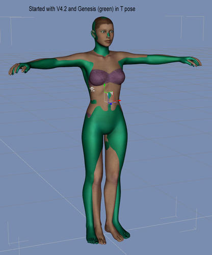

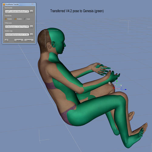

I am running Posemaster 1.5 in DS 4.5.1.56 on Windows 7. I have done a lot of pose copy and paste, but not much pose transfer until today. I am trying to transfer poses from V4.2 to Genesis Basic Female. The tool is working, but I don't seem to be getting results that are as good as the results shown in the user guide. I realize it won't be perfect, but in particular, the head, hands and feet seem to be quite far off. So either I am doing something wrong, or this is as good as it can do, and I have to fix the rest manually. Any suggestions?

    Since no one has responded, I'll offer my two pennies worth. Lately, I've been transferring my collection of freebie poses to Genesis.
    The problem is caused by Genesis Basic Female having a skeleton that's not an exact match to V4's. As you can see in the your top picture, GBF's arms are a little too short, and the hips and shoulders are a little too broad. These small differences can have a big effect on driving and couples poses where everyone's arms and legs really do have to be in the right places.
    You can't get it perfect without tweaking, but three things will help:
    1) Click the "Scaling" box. This will adjust the pose so that the target's scaling better matches the source. This will also have the effect of GBF looking a bit more like V4.
    2) Start by selecting both figures and clicking Edit > Figure > Zero > Zero Figure Pose. When you do, you'll notice that V4's feet point down by 20°. That's her real "zero pose." I've noticed that this sometimes solves the problem of weird foot angles.
    3) When posing Genesis, try posing with the body dialed to the V4 or M4 shape. If the character's body is partially hidden in a car or a cockpit, you can often get away with this. For couples poses, you're out of luck.
    I hope this helps.

    I'm sorry you're having trouble with the poses. If you could share which set it is, I could take a look. As you have already noted, you won't get a perfect match but usually you should get quite a close match. However, the degree of success depends on the specific pose being transferred. From your screenshots, it looks like your settings are right, so it might be you've run into a few difficult poses. The convention is to translate the figure not the hip, but some artists don't do this and it can affect the results, especially if the hip is also rotated.
    In general, poses with more hip rotation/translation will be more difficult for Genesis to exactly match V4's position, such as the driving pose you've shown. The reason is that Genesis and V4 have different origins (in addition to different skeletons) and while PoseMaster changes the target figure's origin during the transfer, hip translation (due to rotation) cannot be fully eliminated. The best way around this problem is to slightly reposition Genesis after the transfer (if needed). You should not notice this effect transferring poses with little hip rotation/translation.
    Where you will really see the difference, is poses that have a hand or foot positioned very precisely e.g. on a hip or touching the nose. Transferring such poses usually requires slightly tweaking the arm/leg to get the hand/foot into the right position. This is no different than applying a default V4 hand-on-hip pose to a voluptuous morph only to find the hand inside the hip.
