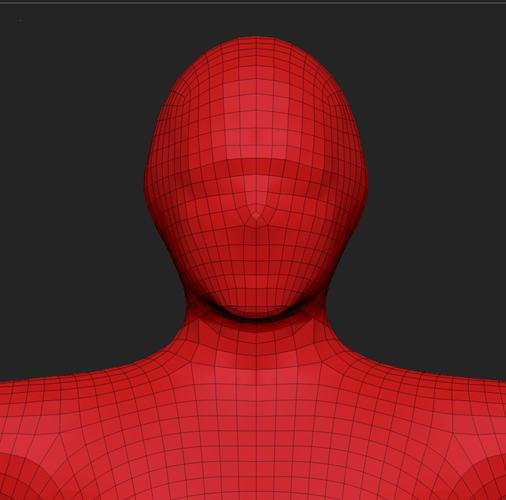

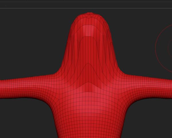

Read up on some tutorials. Not enough info though to finish up the fingers. Anyone know how to make fingers in ZBrush using the Dynamesh? I got the rest done. Kinda fun... except for the thumbs. Cussed my way through that part. But the other fingers are just too skinny so there is not way that pulling out the mesh and remeshing it is going to be good enough. I tried and it was a mess...
HELP????

  • Tramp GraphicsTramp Graphics Posts: 2,089
    Make the fingers out of cylinder primitives. That's what I did to make the fingers on my Battle glove.
