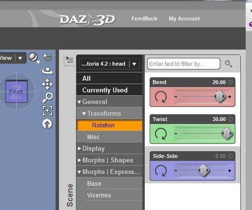

Hi, I am just starting with a little scripting and just needed some pointers please.
I would like to make a script that programmatically changes the values of the head bend and twist, but don't really know where to start.
See my image, I have V4.2 loaded and those are the dials I want to change,
How would I go about selecting the actor and then changing setting the value of those dials in my script ?
In the meantime I will keep hunting, I found some useful things but am a bit stuck on this bit. atm
Cheers :)
517 x 432 - 52K
  • Richard HaseltineRichard Haseltine Posts: 42,074
    You need to identify your figure - usually by selecting it and using Sceen.getPrimarySelection() or Scene.getSelectedFigureList(). Then you can use figure.findNodeChild( "name" , true ) to get the ehad and neck. For each of those use node.getXRotControl() and so on to get the parameters. For the controls you then use control.getValue() and control.setValue( val ) to make the changes.

    Great thanks, figured it out thanks to you :)
